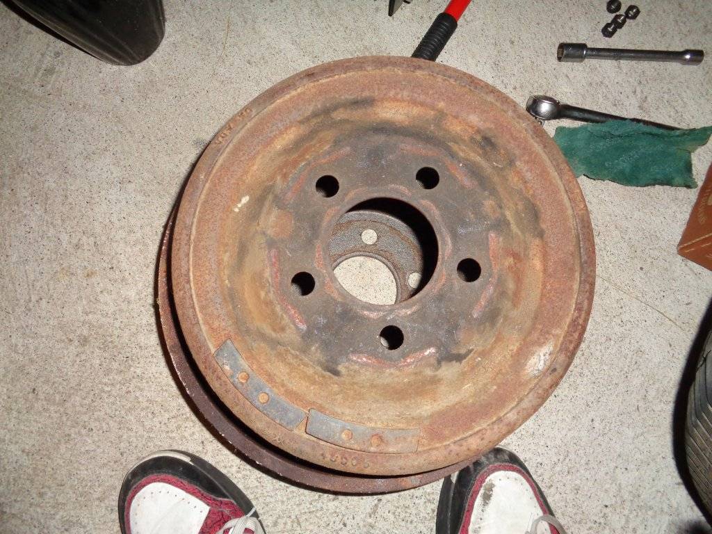

I took the wheel and drum off. it looks like its been hot for sure. The drivers side was a sand color brake lining, this looks a bit cooked or contaminated?
shoes are on right, BOB.

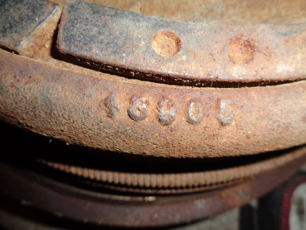

There is somethint wrong with the way the hub is sitting on the spindle. Looking at the photo #3, are you sure that this is the correct hub? Looks like the bearing is misaligned due to excessive wear or improper components. Drum will normally be sweged to the hub as well.
Dave
You mean this slinger cup thing? I think it sits offset downward by design.
So what I did was brake clean everything, the drum too, put it back together and when I spun the wheel, it would catch and rub like theres a high spot.
Maybe the drum is egg shaped and bent? I see what you mean about swedged and I'm at a loss now.
could this be the original fron drums?
this seems to explain whats going on.

Seems the drivers side gets away with throwing the drums on and thats it.
The passenger side not so much. I'll have to pull that drum back off and check the roundness. Its either not true or the studs are worn so that the drum sits off center enough to catch the pads and over heating them? I dont recall having this much trouble with brakes...the worst part is theres no original parts out there.
I think I will try a new drum and see if it spins without grabbing, check that the hub spins with no hops also.

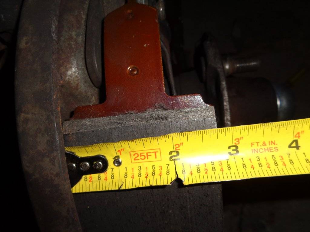

I measured the shoes they are 2.75" and the drum surface is a little over 3"
I took the drum to a brake place and he did some measurements and said its still round so I'm stumped.
The passenger side gets hot and the brake shakes like a warped rotor would, then the sticking pedal....guess I'll try unhooking the power booster next
Just an update. When I put the drum back on and spin it, it rubs then doesnt rub once a full spin. It looks like the drum is wobbling horizontally in and out.

by wobbling horizontally , do you mean the space between the backing plate and drum increases and decreases as you spin the drum? if your wheel bearings are good, i'm starting to wonder if someone smacked a curb and tweaked the hub.
no its like the drum wasnt cast perfect. I just been driving it a few miles then parking, the one side gets a bit hot but I can still touch the drum for a few seconds and it just gets uncomfortable but not burning me. the sticking pedal still rears its ugly head
I put a new drum on and the car was braking great all day yesterday, went 100 miles. Then torwards the end of the day the same front passenger side started getting jiggly under braking. I checked the drums all around a few times wityh my hand and they were all luke warm.
I think the drum is shifting on the hub. this swedging thing and all the other stuff that needs to be done... I watch that busgreasemonkey and I dont see them sanding shoes or swedging wheel studs and thats on 20,000 pound buses. Almost all new cars now just throw a rotor on the hub and go... same in the back even if it is drums.
