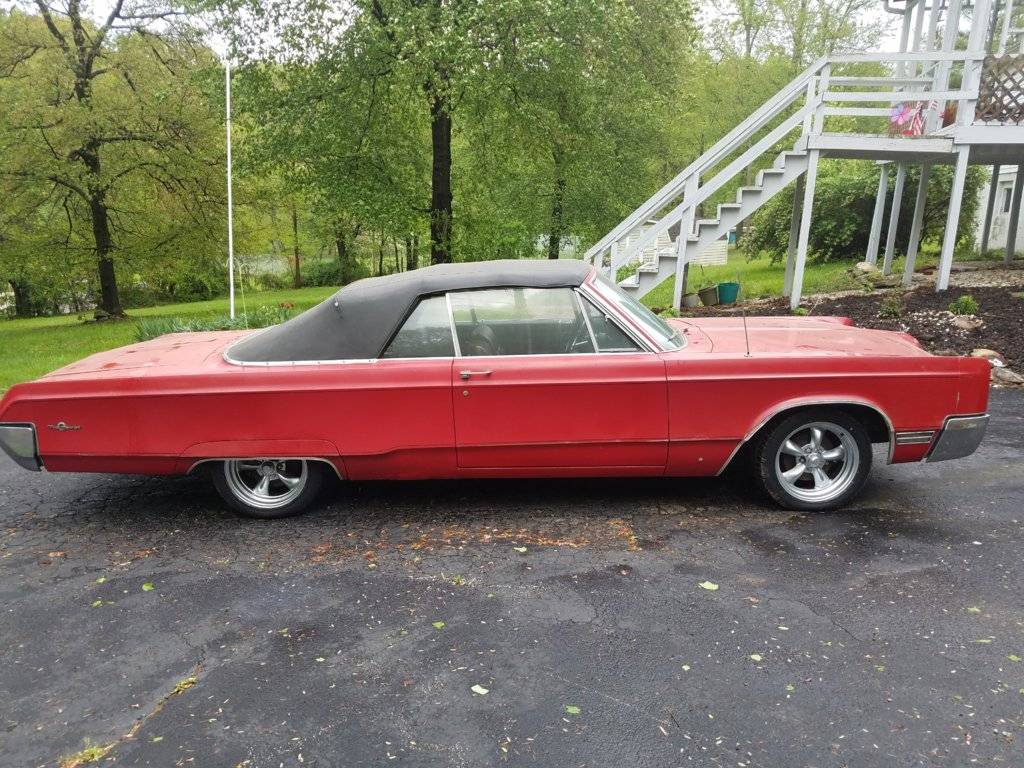

Second glance tells me they are REALLY sagging.Here is a better pic, I dont think it looks that bad but I will get out there and measure tomorrow

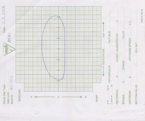

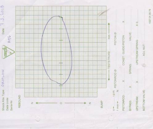

This is a shock absorber dyno sheet of an NOS Chrysler Oriflow front wheel shock absorber. As is shows, the shock has 1250Nm bounce force (compression), and 2200Nm rebounce force (extension). The character of the shock absorber is soft: the compression force comes on very slowly. - Now compare it to a Koni 80-1011 of the Koni Classic series (a shock absorber which is very similar to the obsolete Koni # 80-1742):
Surprisingly, the compression force is less than in the Oriflow, here showing only 750Nm, but the character is different: in the Koni, the full force comes on almost immediately - therefore it feels taut in the car. The decompression force of the Koni is slightly less than in the Oriflow, too, being around 2000Nm. The decompression curve of the Koni is very similar to the Oriflow.
According to the Koni technician, both are excellent shock absorbers, although very different in character, the Oriflow being more comfort-oriented.
I have somewhere a test sheet for the KYB Gas-A-Just, too, only I can't find it right now. The test numbers however were 900Nm compression, 1000Nm decompression, which already tells it is a second-rate product compared to these two.

THANKS for posting those shock dyno curves...
Konis are also adjustable on rebound only. I suspect those dyno curves are for the Konis at the "base" setting? Where can I get some for my Chryslers?

You can buy a set of #80-1011 at any good parts supplier. It’s on production, as it’s a Porsche 356 rear shock. Only you need some manufacturing skills to modify it for a C-body: the bottom bushing has to be changed (piece of cake?) and the top eyelet will have to be cut off, to be replaced with a suitable bolt. If you are a good welder, it’s no problem.
