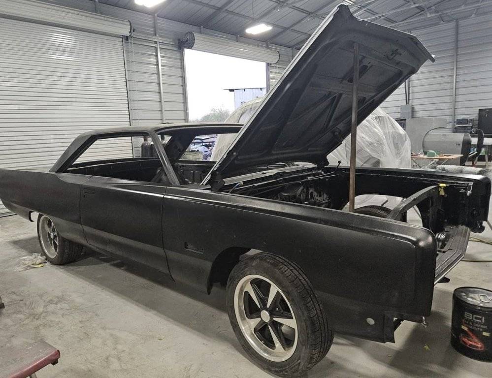

1965-1973 C-BODY - this will allow you to keep the original suspension design but upgrade a lot of the components
Wilwood Disc Brakes 140-15200-DR Wilwood Forged Narrow Superlite 6R Big Brake Front Brake Kits | Summit Racing - dang these have gone up since I’ve purchased them.
https://www.speedwaymotors.com/Wilw...Kit-Mopar-Dana-2-50-Off-Snap-Ring,105634.html I think these are what I went with; but just double check their fitment for our cars.

'Bought my first C-body, don't know anything about them, and want to treat it all apart, remove the fabulous factory suspension's engineering, and turn this car into something it's not (nor will ever be).' Then the main question is 'tell me everything I need to know to do all of this?'
The factory suspension is far superior to anything available back then. Other companies used leafsprings, but nobody optimized them like Chrysler did.
The torsion bars are also an extremely good system.
You best bet is to peruse FirmFeel and see what's available and what that costs. X3 in cost to retrofit something else that likely won't work much better, if at all.
Most resto-mods are are not worth the cost to build them (as far as the inevitable resale).
Without seeing pics of the car, you might be poised to destroy a really nice old car.
