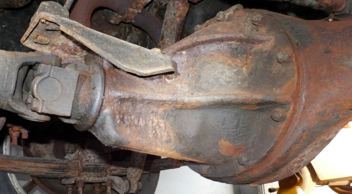

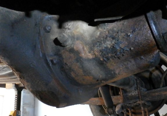

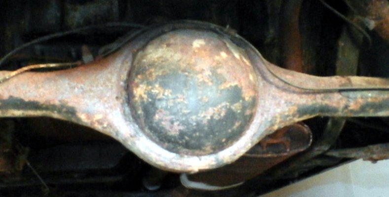

Ok, here are some pics:
If it's needed for identification, I can try to figure out the numbers stamped on the driver's side. I was able to get the plug off by putting a bottle jack under the wrench. I don't think I (or my dad) ever touched the diff fluid. I used a hand suction pump to pull out as much oil as I could. I had just used it about a month ago to do the same thing on my '01 2WD Ram (I didn't want to remove the cover). I got almost 2 L out of the Ram, but I'd guess only 250 ml out of the Monaco. Probably not good. I refilled it with about a liter, maybe 1.5. What is the capacity of this differential?
Alright, so if those are US pints, then 4.4 pints is almost exactly 2 liters. If I get this car on the road for a few short drives in the next week or so, before I put it back into storage I'll rig up something better to empty it and refill with new stuff.
Regardless of type of pints, fill level should be at or slightly below the fill plug opening while the car body is level.
