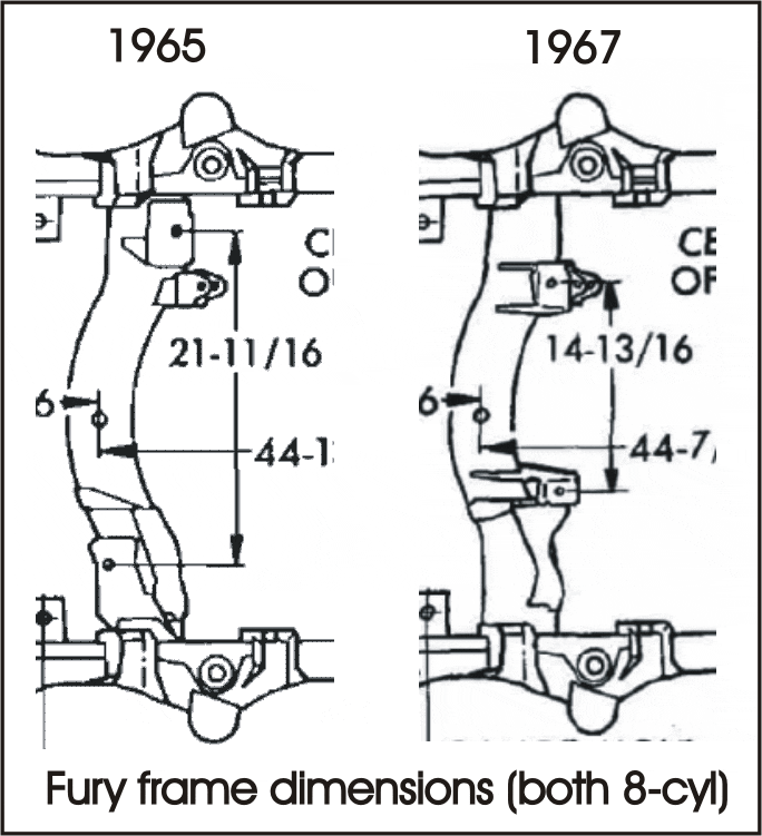

The 1965 Plymouth service manual is the only '65 manual I can find that shows frame dimensions.
I compare the 1965 Fury diagram with 1967. Since Fury had slant-6 and V-8 options for both years, I'm comparing the V-8 diagrams only.
The 1966 Chrysler and Monaco frame diagrams matches the above '67 diagram, so the change or transition in the motor-mount detail happened between '65 and '66.
I believe that 1965 was the last year for the wedge 413 / 426 engines - yes? But weren't also B block and A (small block 318 polysphere) also engine options for Fury in 1965?
I'm trying to understand what V8 options were available for the Fury in 1965, and how could all of them sit on those same frame mounts. And then the mounts changed in 1966?
Did all Chrysler frame engine mounts also change from '65 to '66 ?
(I now believe I have the above 1965 Fury V-8 frame, I will take a tape measure to it tomorrow and see if I get 21 11/16" between the holes)

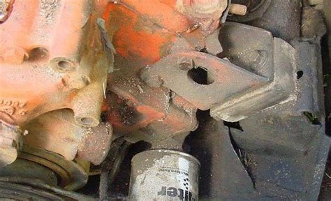

In addition to an Uncle Tony video detailing the different 1965 B/RB engine brackets, there are a few other places which mention it. Plus the boss on the lh frt of the block where it bolts in. With that bracket, it is attached to the lh lower frt of the block and also to the side of the block. Unlike later model and B-body mounts which attach "as expected" on the side of the block only. The parts book illustrations also indicate the uniqueness of that particular B/RB lh frt engine-side mount bracket.

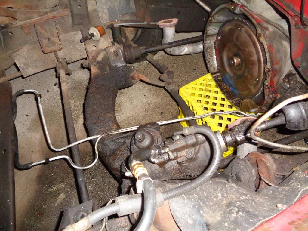

Arg. I don't care about engine history and options. What do I have here?
And what can I do with it?
If you don't need it, sell it.
I can't sell it without being able to tell a buyer what will bolt up to it.
I would use it myself if I knew I could bolt a small-block up to it. Without doing any welding / hacking.
I like the wide mount positions they had in '65. Much more sturdy for the engine and the frame if you ask me.

I’m pretty sure that left mount forward of the steering box is 65 big block only. I believe small block and slant use the more conventional mounting next to the steering box. If you want to bolt a small block to this stub without fab work, I don’t believe that to be possible.

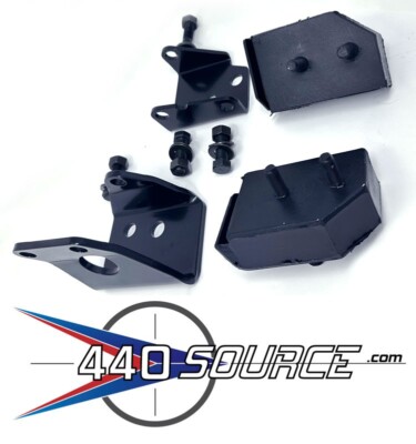

As a side note, 67-69 big block A-bodies used the 65 big block mounting system on the drivers side. If a guy is building one, there is the factory engine bracket, the 440 source engine bracket (both require the correct bosses on the front of the block, and there’s another mount that uses mounting locations that should work on any big block. This last option does not look factory, and I don’t recall who makes it.

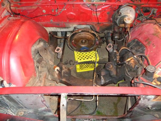

Check the link provided and look through the pics. There are some of the short block in the engine bay where you can see the mount in front of the steering box. Later in the thread there are pics of the left mount on an engine. Maybe the guy who started the thread has an engine bay pic without the engine so you can see the k member mounts.
