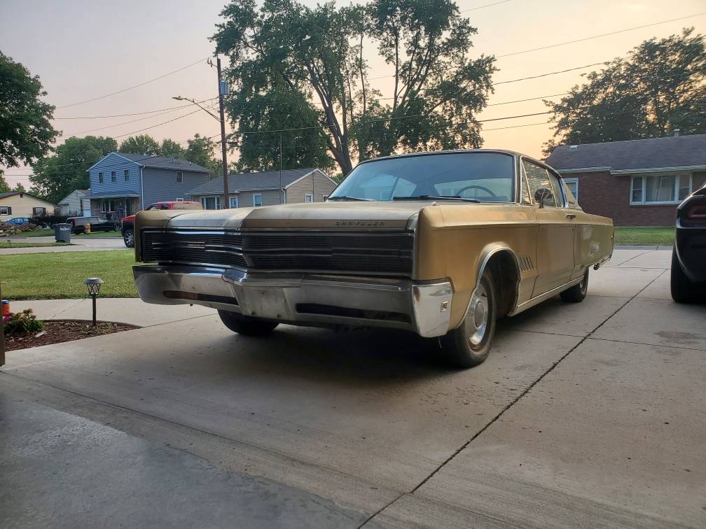

I got 1 good pic of her before A) it got dark. And B) I had to get the trailer back before uhaul closed. More tomorrow.
