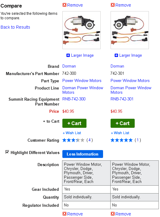

I assume with the Dorman 742-300 and 742-301, one part # is for the driver side and the other is passenger side, but which is which? Summit's description doesn't help :P
