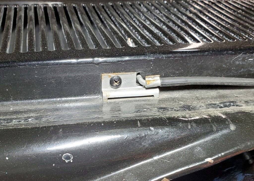

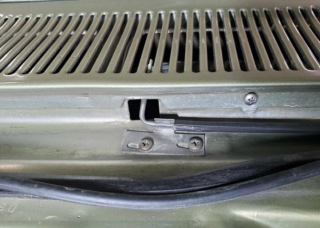

They might be able to be bent to work, but are not the same. I have a 68 Fury and a 72 Dart in my garage next to each other and just took a look at the two and compared them. The Fury has the double screw while the "A" Body has the single mounting screw and mount is different. The "A" Body unit is also about 1/2" shorter that the "C" body unit.
Damn.
The c-body nozzles don't exist. it looks like the Van's part is like what's on your Dart. Crap photo on their site as well.
Really appreciate you posting the photos. I'll use the Fury photo to try and track down the correct part.
