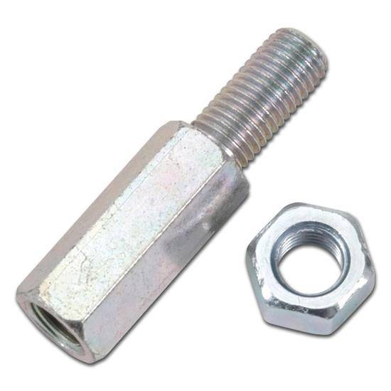

If the car was an original 2bbl car, it might be that the kickdown linkage also needs a spacer piece for correct kickdown rod adjustment. The spacer screws between the two threaded sections, lengthening it for correct adjustment. The Edelbrock part number should be "3258004". Looks like you might also need the carb throttle stud, which is longer, so the linkage is more parallel to the rocker arm cover?

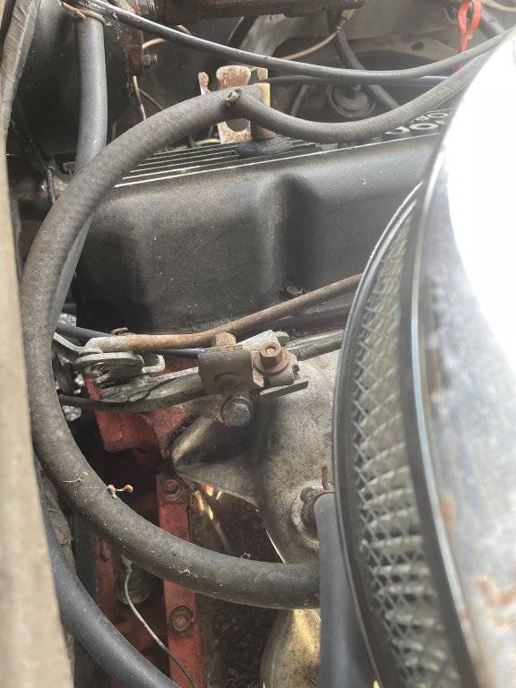

Super helpful info on that link. Thank you! My big concern is that the throttle bracket looks to be for a 4bbl 383 on a b and e body. I didn’t know if it was the same part on a c body but some sources say it isn’t.

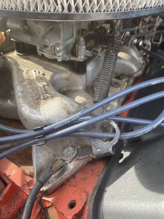

ok couple of things...never saw a bracket that had a second cable hookup location...maybe that would have been for cruise control?...the little foot on the lower front of the bracket should sit behind that square block cast into the manifold, not along side it so something's up there...there is a hole drilled into the bracket and 2 more in the bell crank that you slide a rod or drill bit through in order to put the bell crank in the correct position to adjust the kickdown linkage...this may have been fooled with if someone was trying to make 2bbl rods work...dont know for sure about the 383 version but the 440 performer sits the carb 5/8 of an inch higher than stock...the 2bbl bracket has a longer arm for the narrower carb so people bend it up to get it higher and further out and thats what you might have at the moment...so even if you chase down the correct 4bbl bracket you will need to modify it to line up with the performer....i had to cut mine and splice in piece of steel as well as relocating the little foot...looks like your cable is on the wrong side of the nut on the hold down clamp as well

Yeah, there are a lot of things that don’t jive on there. The carb does have a 1” spacer under it so I’m sure that adds to the mayhem. I noticed the cable being clamped in the incorrect spot and the additional cable clamp piggy backed on the other. Show season is coming up so I should be able to get some good reference photos from comparable set ups.

Looking back at the pictures . . . it is obvious to me that somebody "rigged" things with little apparent knowledge of what was needed to do the job OR how they should have been with a normal factory 4bbl set-up. FWIW. But, respectfully, was trying to get by with what they had on hand at the time, without buying anything else . . . OR knowing that some things were available from Holley and Edelbrock?
When I put the TQuad 9801 on my '67 Chrysler Newport factory 383 4bbl, with a Torker 383, too, I was able to use the existing throttle cable, with some repositioning in the hold-down bracket. But I needed the kickdown rod extension (see earlier post) for a correct adjustment. Although the TQuad is a 4bbl too, the primaries are a significant bit forward than the OEM AFB was, hence the kickdown rod extension was needed. Probably similar with going from a 2bbl to a normal squarebore 4bbl too?
At the very LEAST, a new throttle stud is needed, cruise control or not, to get the linkage more parallel to the valve cover, rather than scrunched together as it is. There is ALSO a bolt-on bracket for the throttle arm on the car, to adapt a non-OEM carb to a Chrysler product, which also appears to not be there. Once that bracket is installed correctly, everything else seems to fall into place, with, of course, the correct throttle stud. From www.holley.com, the throttle stud (which should be long enough to use a cruise control cable, if needed) should be 124007DEM and the basic (needed) add-on throttle linkage bracket (attached to the carb throttle side) should be 20-7.
Getting the 20-7 bracket will space the cable and rod out from the carb. The 124007DEM will also separate things some more. A studs are in the Edelbrock catalog, too, even the one without cruise control, as I recall. Those two items, plus the extension already mentioned, should get you to where you need to be, provided the rear linkage bracket can still be used.
