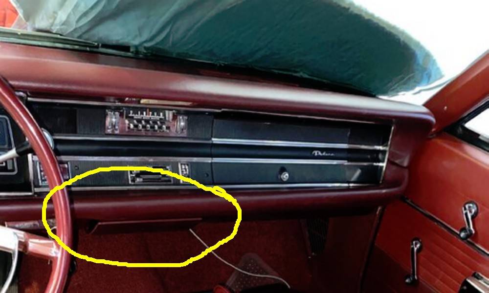

You might be able to install it where the ash tray goes with a custom mount.

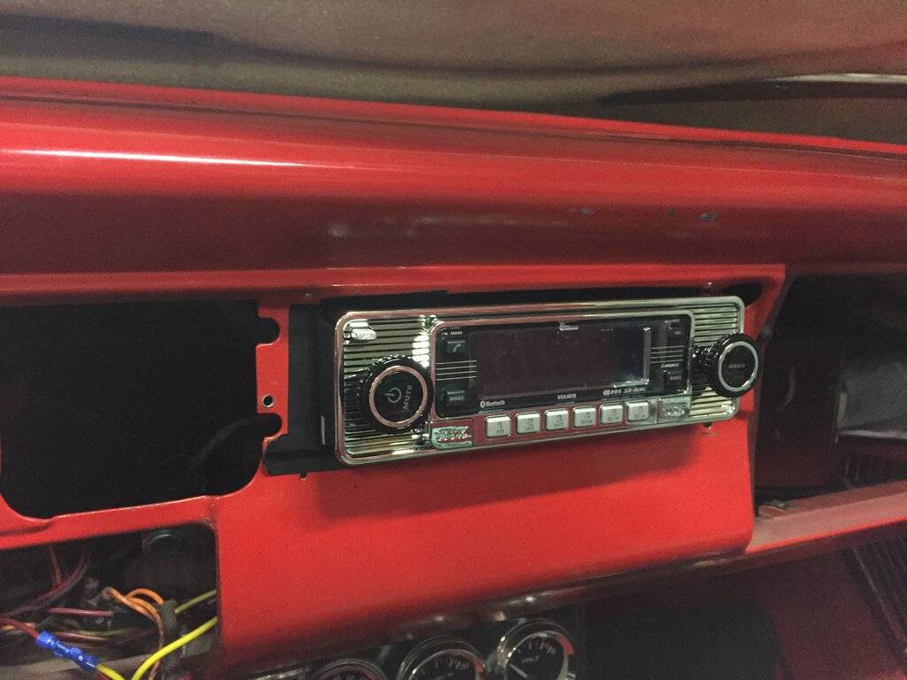

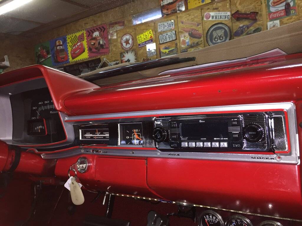

Not sure of the look you are going for but you will have to sacrifice some metal though unless you get the OEM gutted and modernized...
I still had to carefully square out the hole from the factory since there is no manufacturer of the old Craig R3 systems that have the adjustable position stems anymore.
My dash was a bit hacked up from the R3 install from a PO so it wasn't so much of a decision to make.
I installed this into my Polara convertible which was a huge upgrade from the old Craig R3 & it's great at lower speeds.
In a HT it should provide plenty of sound at a reasonable price.
Wish you all the best in this part of the upgrade.

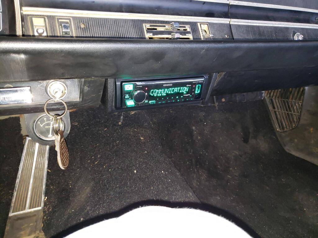

I ended up mounting the stereo in the ash tray area. I removed the ash tray, then cut a universal single din mount from metra (99-9000) down to about 5" deep with a band saw, which allows it to fit in this area.
The radio I used is a kenwood kmm-bt728hd.
Eventually I will make a pod to go under the dash for front speakers. For now I'm I'm only using rear speakers.
These are kicker KS 6x9s (47KSC69304) with "boom mats" underneath. Also, I used a $13 rubber backed utility rug from lowes to make a new package tray cover. In the spring we're going to fix the leaking back window and put a new vinyl top on it, then I'll get some actual hard board.

That would work for most people. Like I said in the first post I want more control, and for the price you can't beat a head unit.
Also I didn't modify anything but a $12 radio mount, the dash is untouched. if I want to go back to stock it would take 5 minutes or less.
