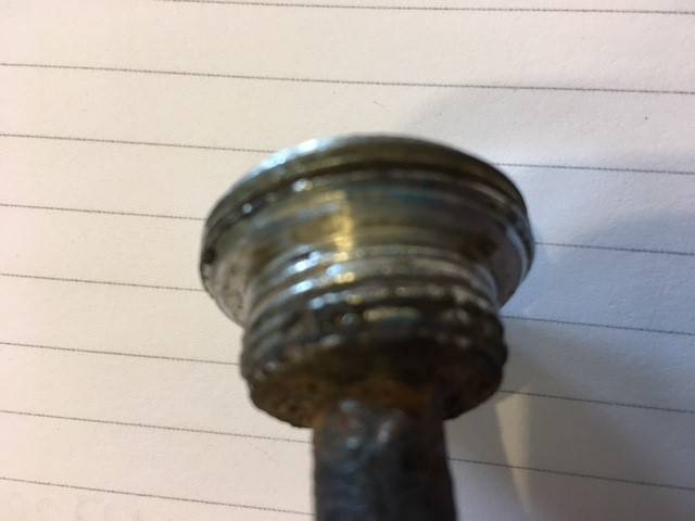

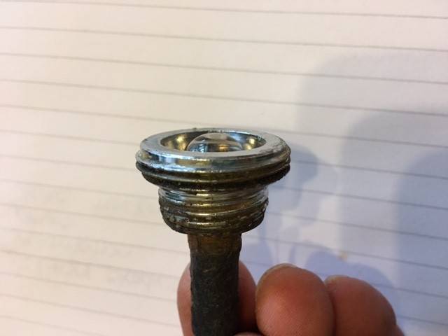

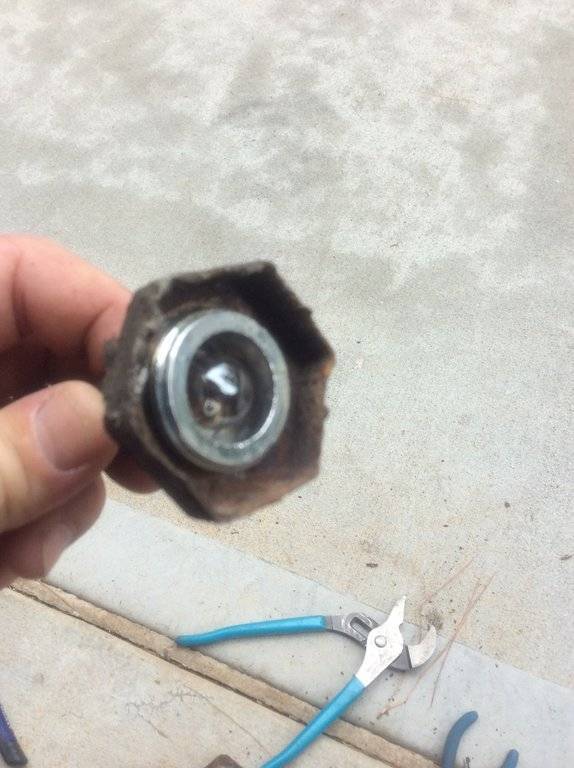

i cant seem to get torn down to get to the bulbs. I have the socket out of the outside housing (chrome circle and lens) but that's it. I read a post on here about Imperials but mine look different. The pigtail just spins when I try to remove. What am I missing here?
That's three pieces you're holding in the photo, not counting wires, bulbs and such. The back side should just pop out of the pot metal piece.
I was able to get the pot metal piece out, but now what? The pigtail and bulb spin inside the chrome housing.

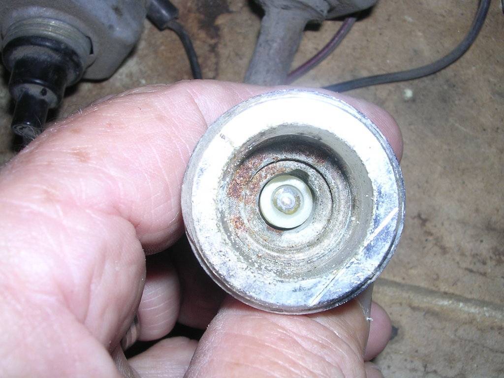

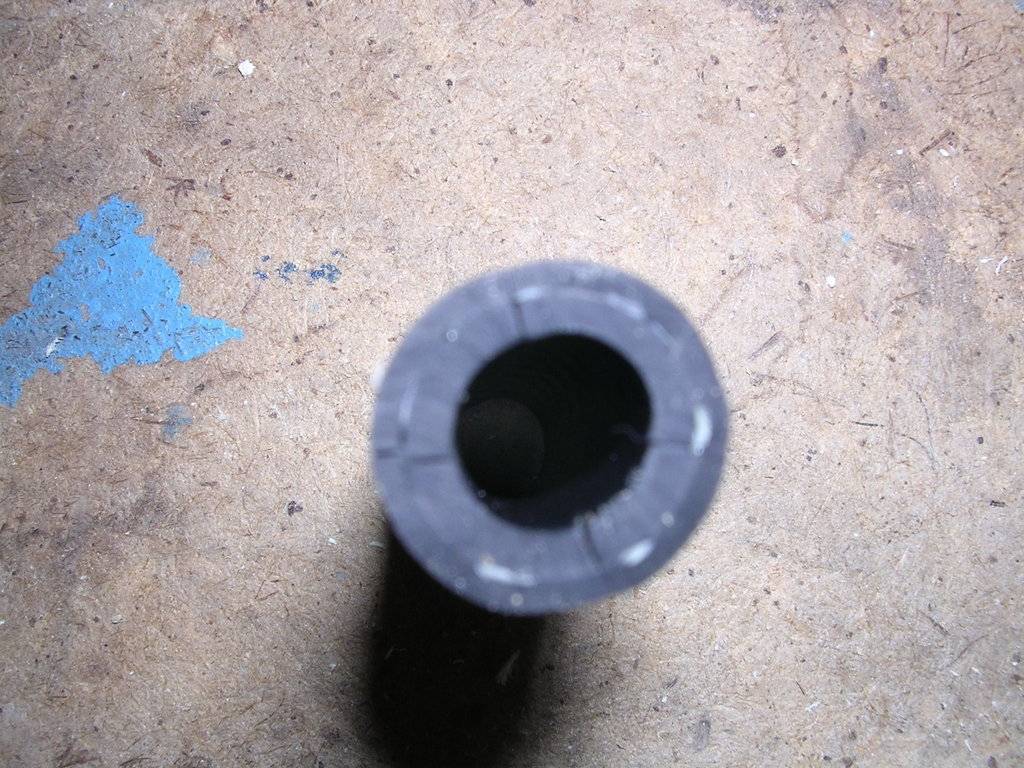

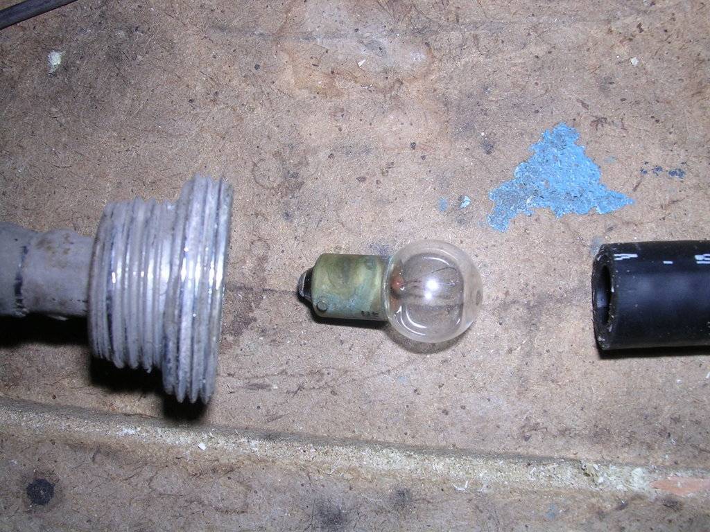

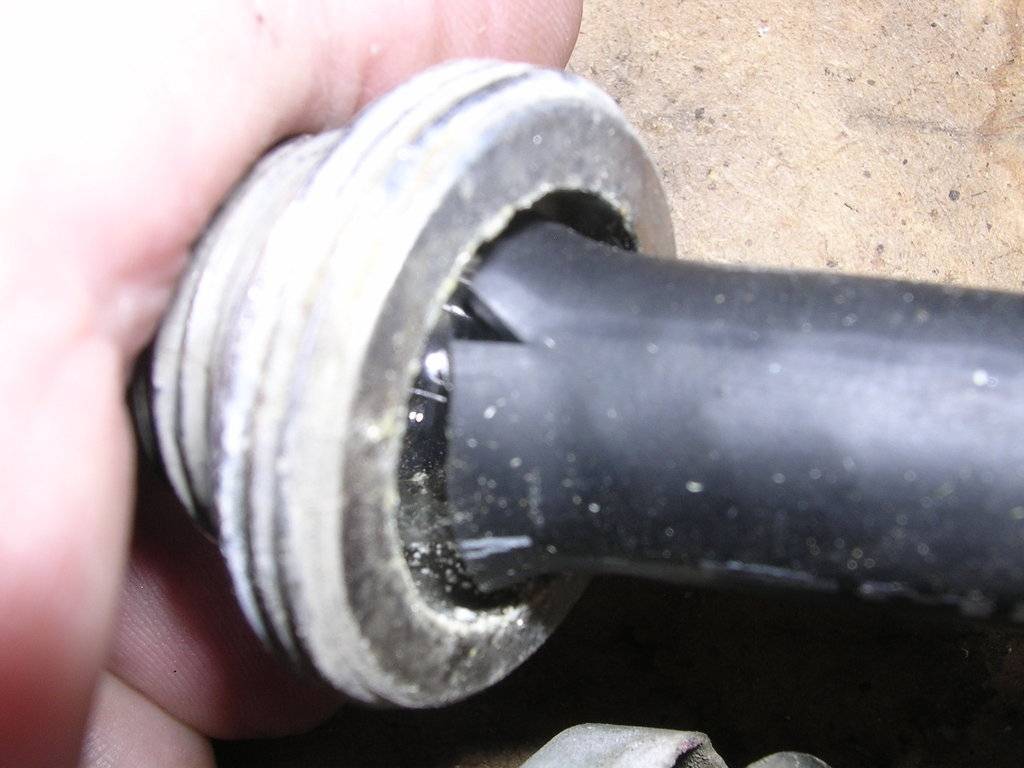

Okay, apologies - I was remembering the rears with the snap in socket. Dug one out and I think it won't come apart easily, i.e. not meant to do so. I was able to get the lamp out of mine fairly easily with a little trick I learned a while back for countersunk lamps like that. I cut a one inch piece of 3/8" fuel line and put a small cross cut across the end about 1/8" deep, then use that end on the bulb's envelope to press it in and turn, should pop right out if the corrosion isn't too ugly.
You can kinda see how it's cut here and below.
Awesome work! I'll try that today. I appreciate the help. No way my fingers can get down in there.
