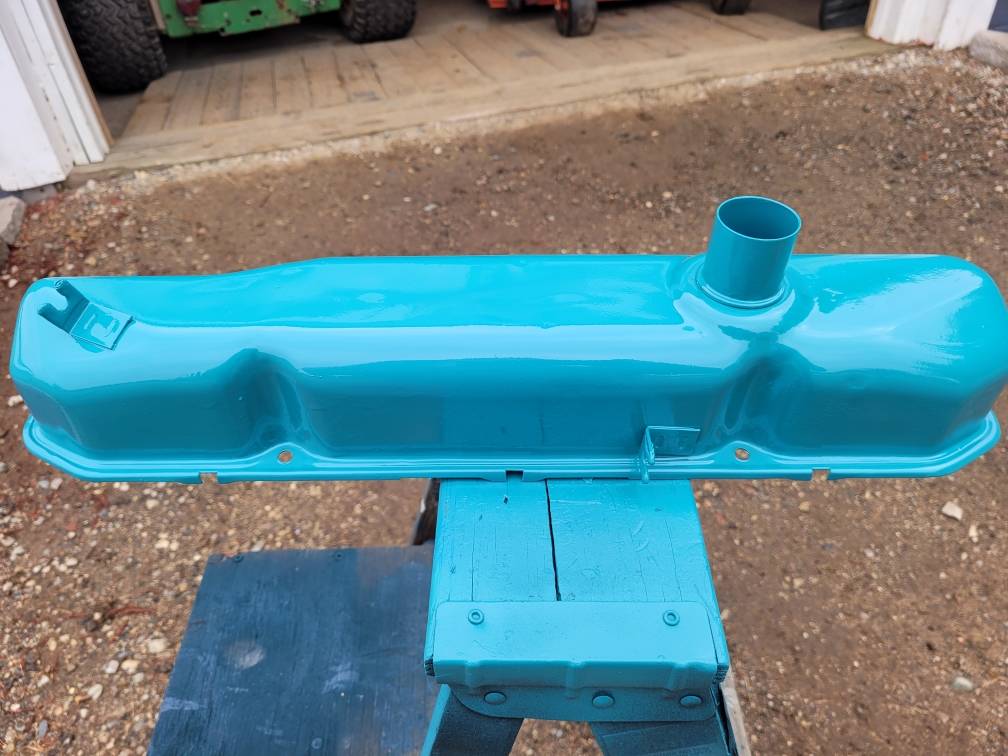

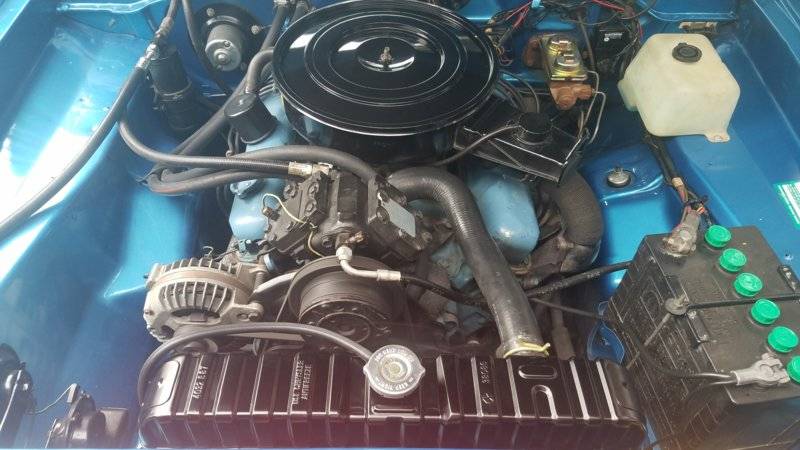

my best results are using this brand. cap is NOT the color in the can. to me, it looks as "original' as the original.
it gave me first engine color below (not my engine but i used color on my '65 413 refresh, 5-6 other pre-'71 projects).
modern "Chrysler green" gave me what went on my '67 Newp 383 refresh two months ago.
you decide, but i wanted first color but i got second one.

my best results was this brand. cap is NOT the color in the can. to me, it looks as "original' as the original.
it gave me first engine color below (not my engine but i used on my '65 413 refresh, 5-6 other pre-71 projects).
you decide, but i wanted first one but i got second one.

here's some disclaimers - sorry for long answer
1. it is the color i compared my 69 non-HP engine to when we finished it.
2. i am traveling and do NOT have the finished '69 non-HP photo on my phone. I do have the sample color i wanted, thats actual pics i used ..dont even know if thats a 413) to pick the color in the two cans i showed.
I took degreased, original valve cover/intake that had sufficient samples of factory paint still on to get optically scanned, sprayed these recommended paints and then scanned them. Paint guy said formulae were essentially same. So did my eyeballs.
So we did original valve covers/intake before doing whole engine while it was out of the car. I stuck with it for other pre '71 my non-HP mills
3. so, my short answer is "Yes, its most correct for '69 to my eyes/tastes/lighting/camera brand, etc".
I only offer my experience up as "data points" (i am NO expert) but NOT as definitive "do that" advice to anyone AS THEY should test what THEY like :) (its potentially a big decision for many kinds/qualities of restos, so thats left to others to decide for themselves IMHO).

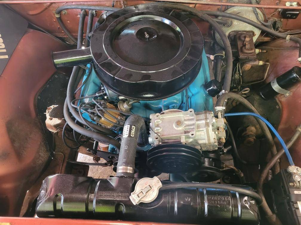

This is my '67 Newport done in modern "Chrysler Green" two months ago... too "blue" to ME. some people see it and they see "turquoise ... I don't.

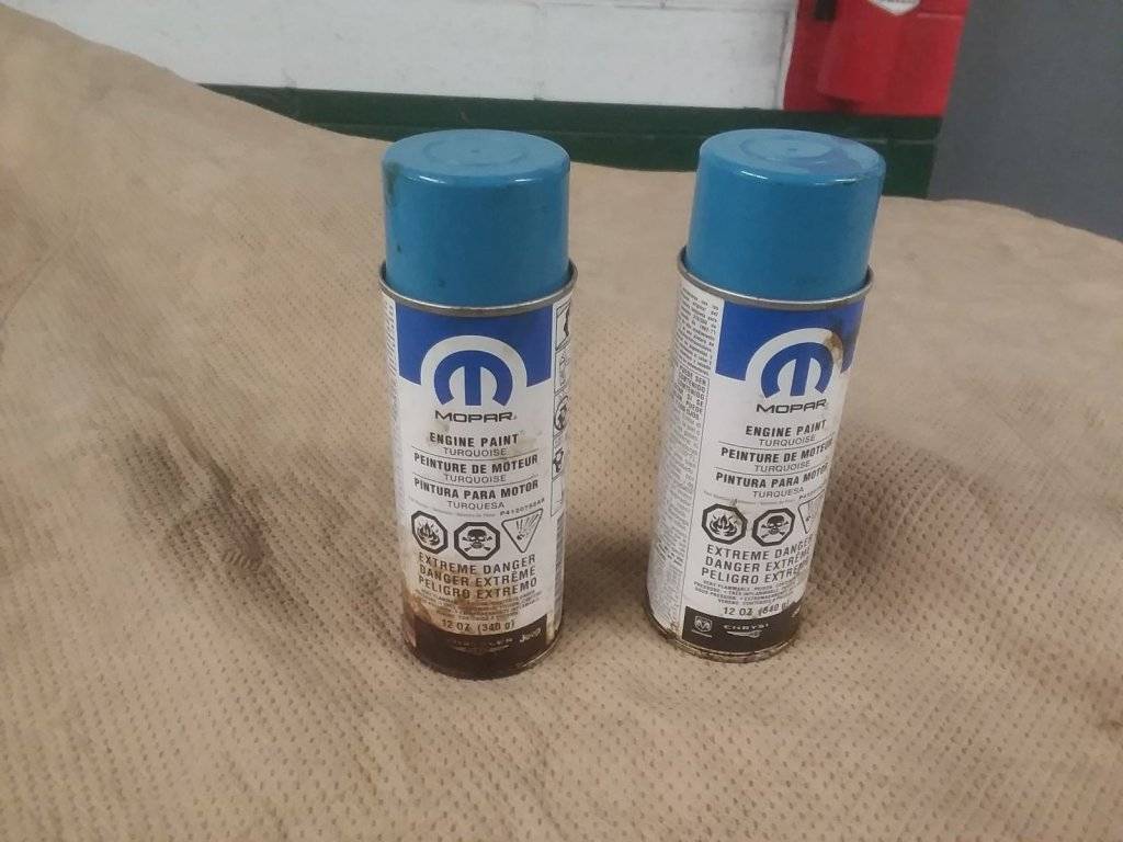

Anyway, friendly advice is to try to get --- for any brand available today -- a "sample" of what is "advertised" as turquoise to see IF its close to what you want.
I bought 40 "Mopar" cans (used 30 of them, so 9 cans left and one can that wont rattle anymore), 10+ years ago .. even the same brand today MAY be different (environmental reasons, cost, whatever, may make the formulas change.)

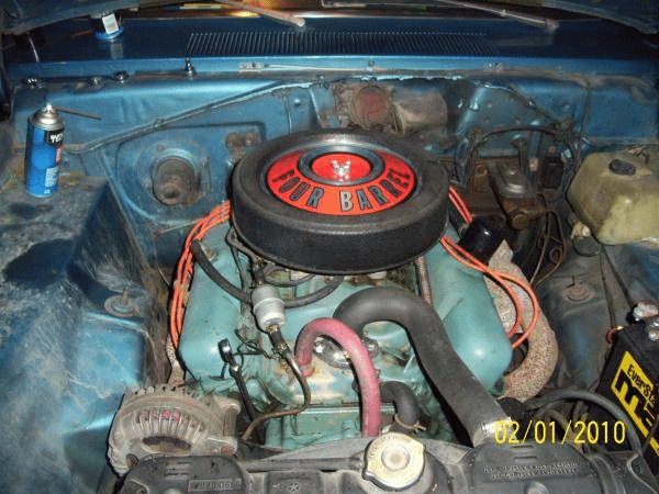

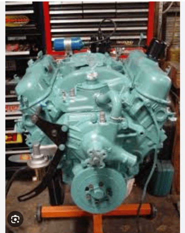

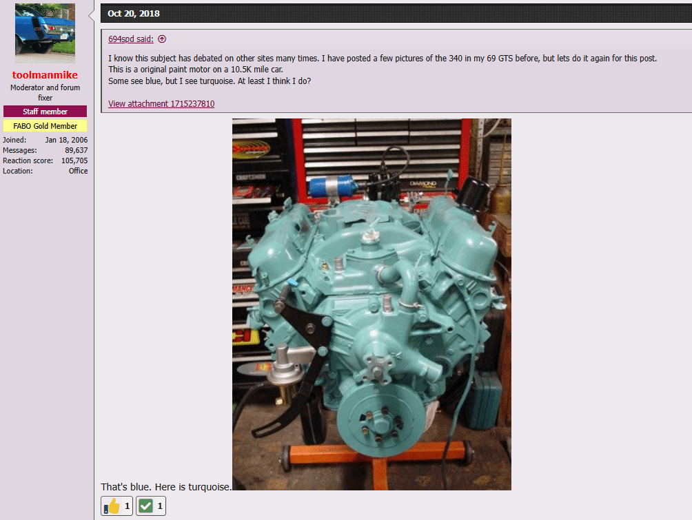

I did my "turquoise" recon mission about 10 years ago. My example was this one .. turned up in two places, one of them from the UN-impeachable @Toolmanmike (think same as ours :poke:)
here about 2018.
the one below about 2012 - same picture, looks like turquoise to me.
engine seems (per OP description) to be a '69 340?.
anyway, whatever it is, that's my preferred "turquoise" right there. somebody else might be using/seeing something else.

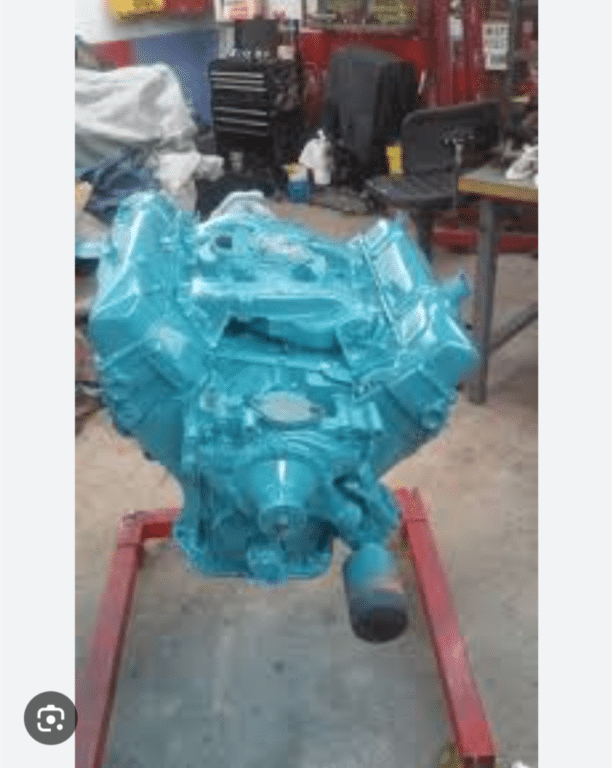

This is the color I grew up on/remember from when I was barely tall enough to see over the fenders into an engine compartment. :)

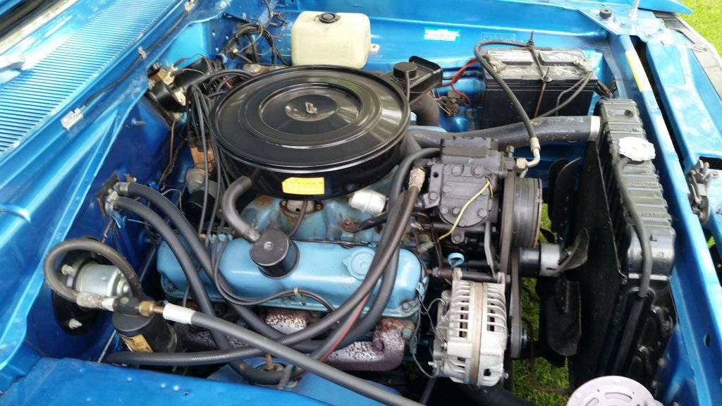

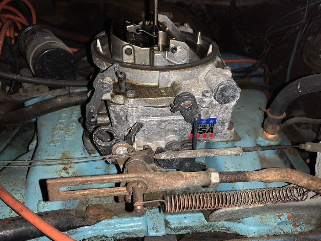

My car came to me with blue valve covers and aqua intake, but it was upgraded by the PO to a 4 bbl so I'd guess the blue is original ?
your intake looks "turquoise-ish" to me.

Studying the pictures and great comments again, even if not the true turquoise engine color, and if I'm reading everything correctly the Mopar can engine paint looks better to me than the Duplicolor. Plus it's a few cents cheaper!
