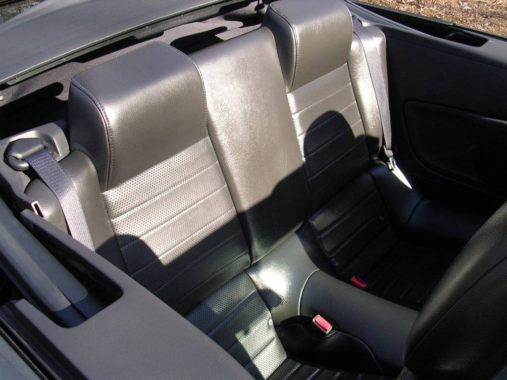

Would be cool to fab something like this, but I don't see how we could keep original seat belts.
