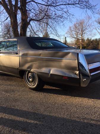

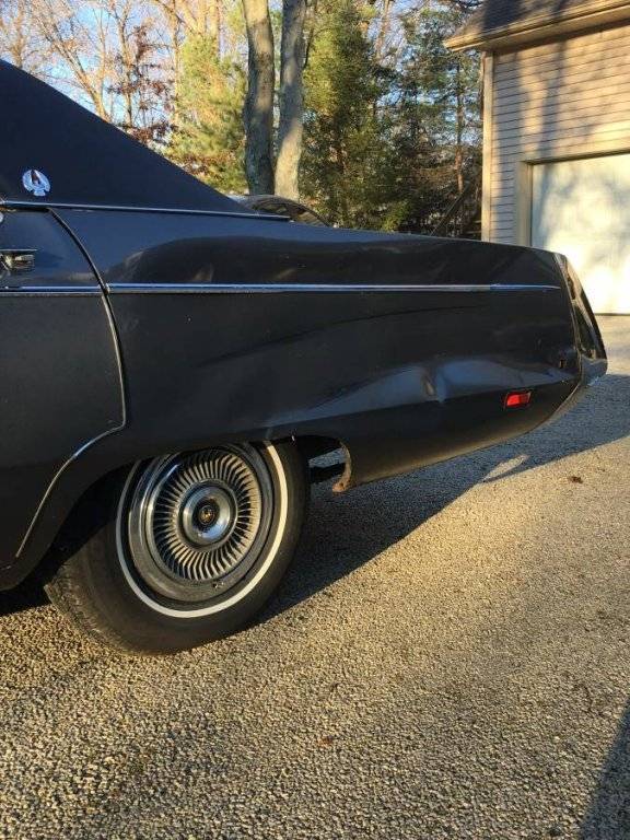

How much you think it would cost to fix something like that?
not an easy fix. the body lines are destroyed. best bet might be to replace the quarter.
Most of that would pull fairly easily, the low line is the tough part. The crease at the bumper and over the wheel, and pinch at the top, fighettabout it
What a shame, but even with the cost of repairing the dent, rust and respray, it wouldn't be as much as some other folks are asking for their similar vintage Imperials.
Have all of the Fusie 2dr Imperials disappeared off the face of the earth?
Even if you went heavy on the dough, it's better than scrapping the car. It's not structural. A cheap way into the hobby until your skils get better.
And if you wanted to do it right, any '69 Chrysler C panel would work. (or '70-'71 with more work).
Wonder if that's a fresh dent? Heartbreaking if it happened to a recently acquired classic car. Suregrip on ice situation?

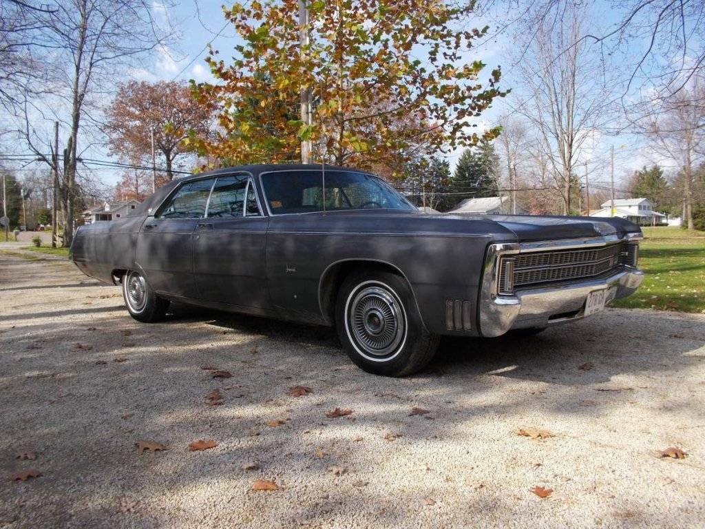

SELLER DESCRIPTION
1969 Chrysler Imperial with 61K miles, 440 with 4 barrel, 727 Trans, leather interior, vinyl top, new tires & exhaust. Runs & drives great. Rust minimal, garage kept. Damaged left rear quarter (see photo). $3500 or best offer.​
