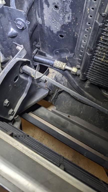

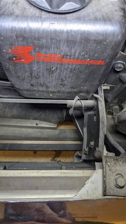

I'm installing the lights on my car that Didn't come with the hideaway's.
at Carlisle I noticed the 300's lights have a little round spring's where the bar turns the lights up.
mine didn't come with these springs.
where can I get them? and are they really important?

My 1970 Fury with hidden headlights does not have springs where the bar turns the light covers up. I don't think they're necessary.

they were tight against the bracket, bout 2 loops and 1 loop was bigger than the other.
I thought it looked like it assitted in opening the headlight door somehow.

I wouldn't worry about the springs. Put it together and enjoy. 1970 Fury hidden headlight is an awesome looking grill!
The Fury put the springs on in 71 to help the doors shut a little more easily vs slamming shut.
