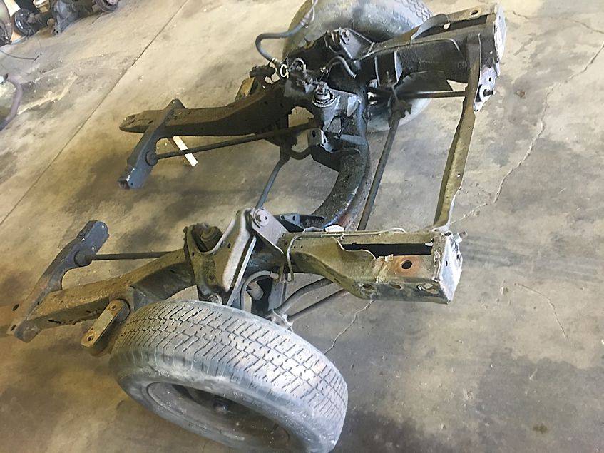

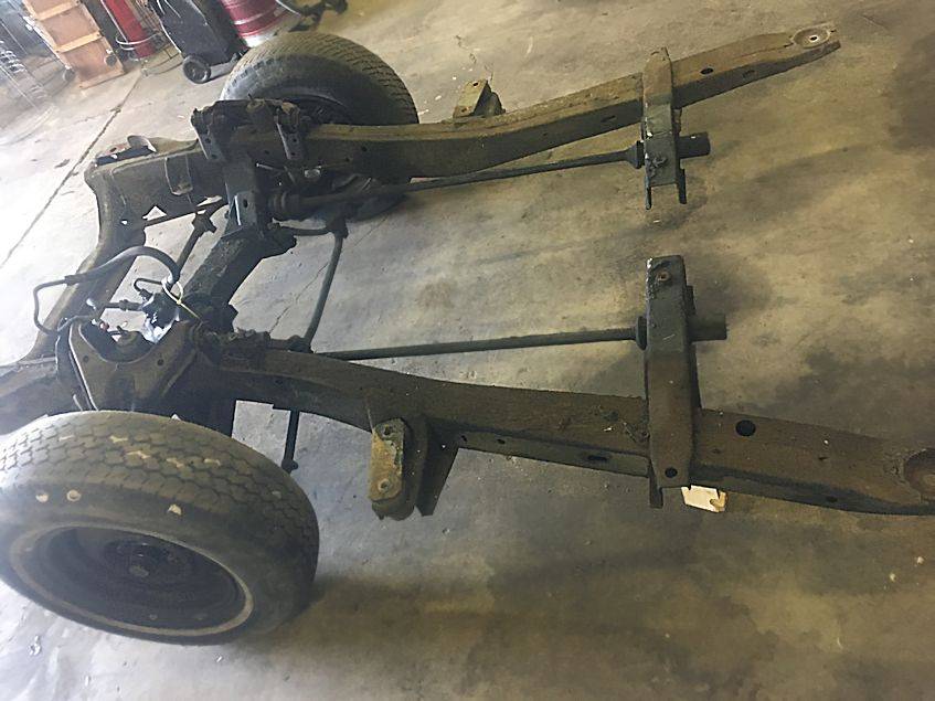

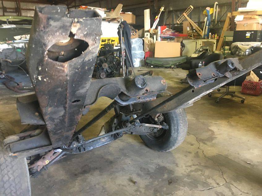

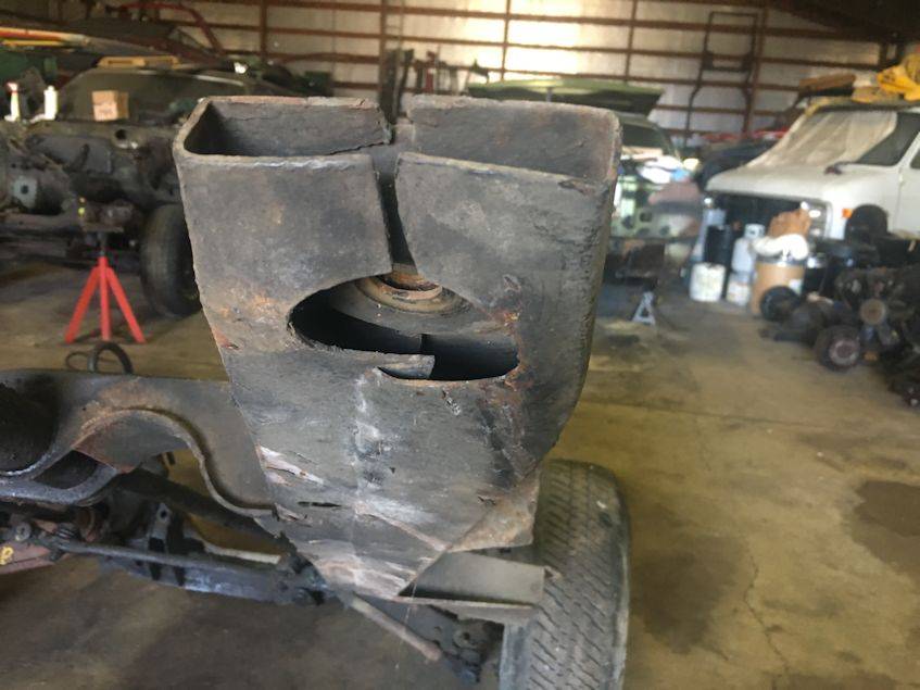

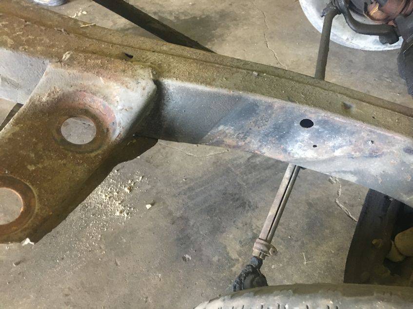

The rust on the trailing ends is pretty bad. WOuld be easier to replace than restore. Problem is it has to be the Torsion Quiet Ride frame which had side rails extending 16-1/2" past the transmission cross member. Only used on the 70 hardtops and all 71's. Not sure of 72-73.
