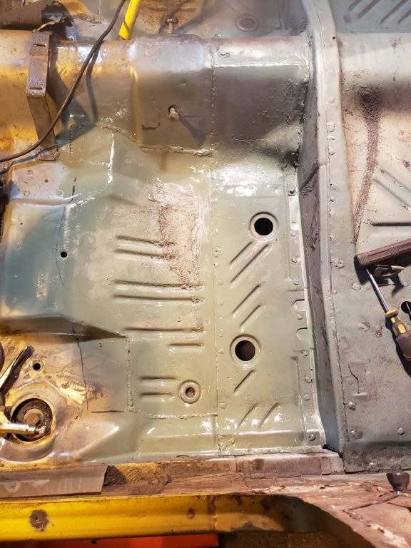

    One more patch and the floors are done...

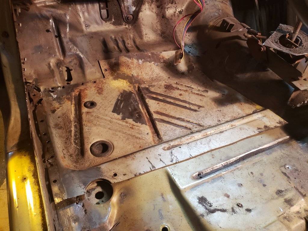

    Covered in etch primer for now. Still have some grinding and finish work to do, but it's to a point where I can move forward

    Last of the major cancer in the floors cut out....

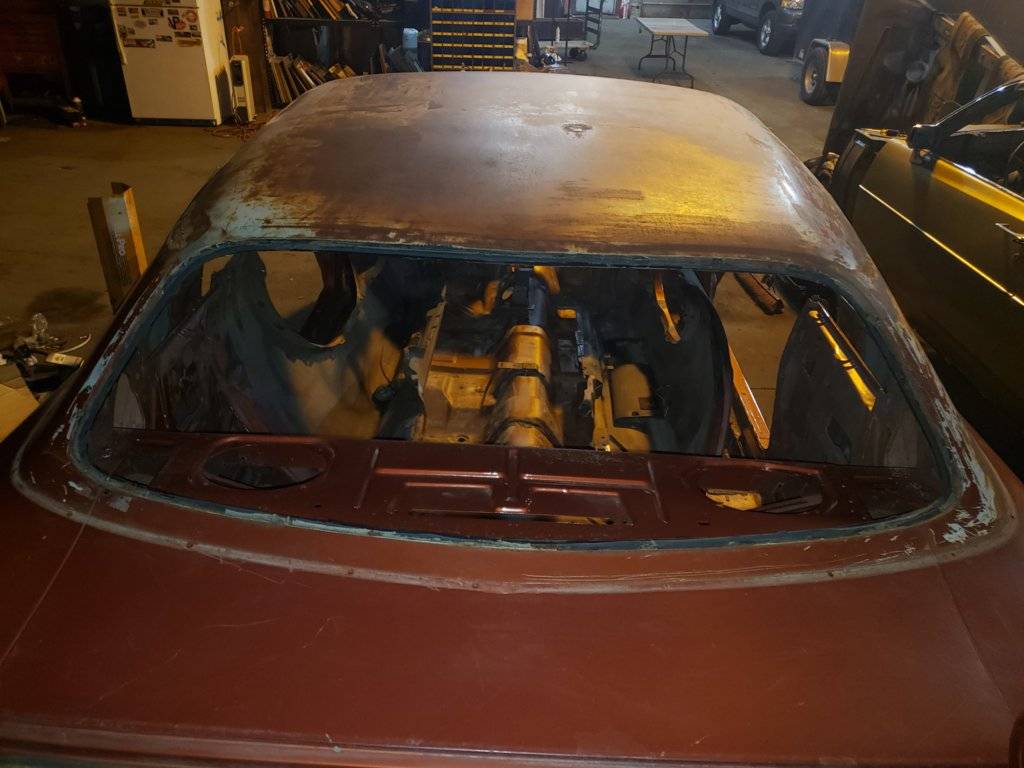

    The "donor car" arrived. I am really having a hard time with this. The FK5 is a pretty nice body. I thought the trunk was rusty but it's got some surface rust from the mat and should clean up...this leaves me in a situation.
    Build the better car despite my efforts?
    Build the better car for now and move forward with the rust repair on the gold car to have a solid shell for the future?
    I know it wont be the Real car. But at the same time I have an equally rare car that doesn't deserve to die....there must be a way.
    Who's got some solid doors?

  18. 71Polara383
    71Polara383 Kid with ballcap FCBO Gold Member
    Messages:
    1,868
    Likes Received:
    2831
    Joined:
    Dec 10, 2016
    Location:
    Rockford,IL
    They are sitting out in the yard at my job...But I would NOT be making it a 70 Monaco. I'd cut all that out to make the car a 71. I want a 71... Not 70. Polara. Not Monaco.
    The way I see it is I have a solid west coast body...what I initially thought I was getting with the Brougham...but I got an Oregon rust bucket. Its mostly solid now but still needs alot, but I'm not gonna cut the car up and say screw all my hard work. I would however put the car on the back burner and collect more parts to eventually have 2 cars.
    It does not make sense to me to cut either car up. But it does make sense to make 1 solid car from the 2 and keep hunting for parts and keep welding on the gold one...
    Worst cast... I have twins.
