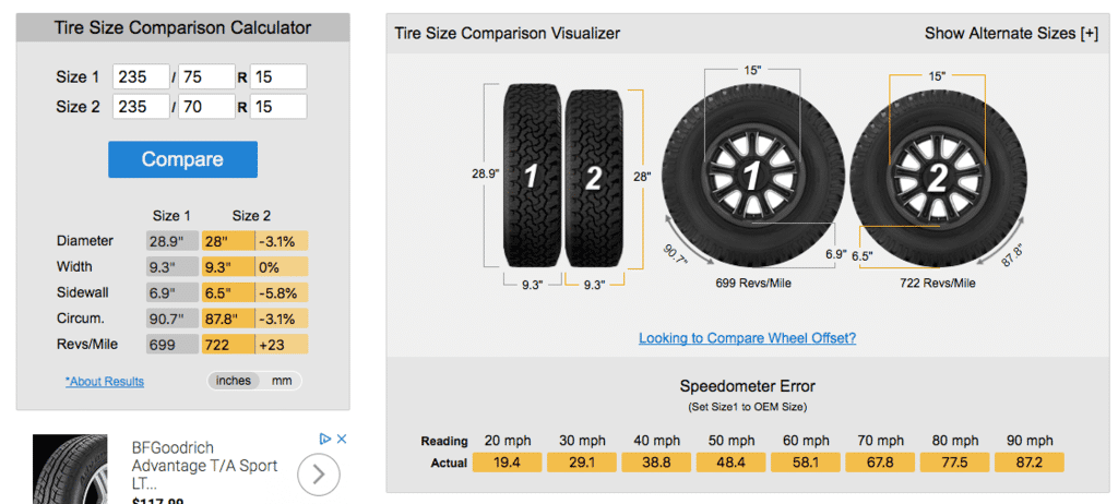

Hey, Wagon Owners, any of you bought tires for your wagon which were designed for a Full-sized van or a truck instead of the normal passenger car tires? While my '72 Custom Suburban does show duty, it also is called to service for hauling. And, it runs a lot empty. Just like a Cargo Van. Given its size, capability to transport large loads, it got me wondering. The 235/75R15 is a very common Van size.
I used to drive an 15pass Dodge Van. Other than sitting up high, it and my wagon felt very similar going down the road. Loaded or unloaded.
Curious if anyone else had explored this?

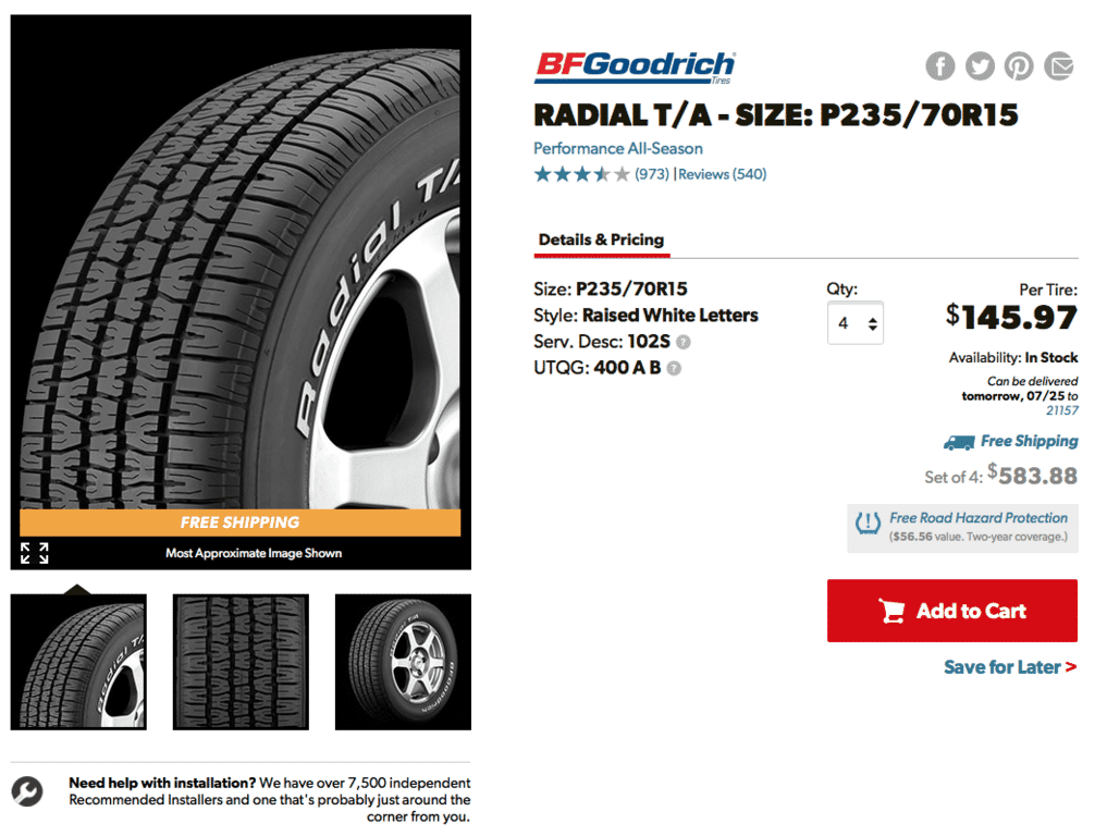

I would say those Goodrich tires pictured have a worse reputation than Coopers or any other for that manner.

No need for LT tires for your application.
Kevin
You would be better off buying the highest consumer rated tire you want to afford

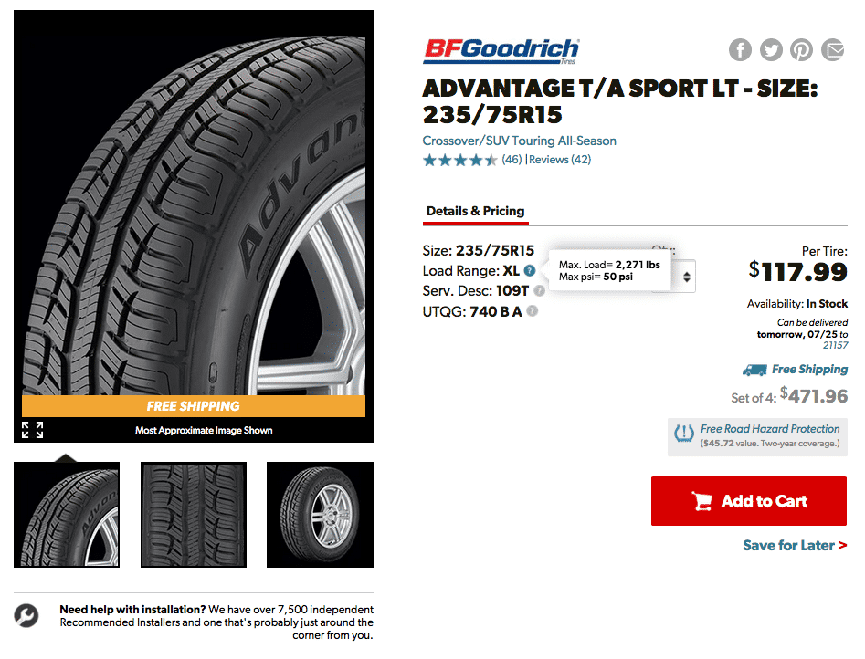

I didn't notice before - I just bought those advantage sport t/a's for our minivan based on tire rack reviews.
