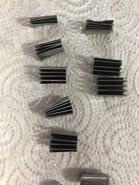

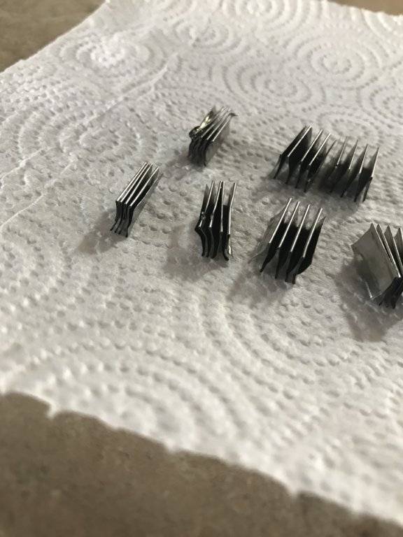

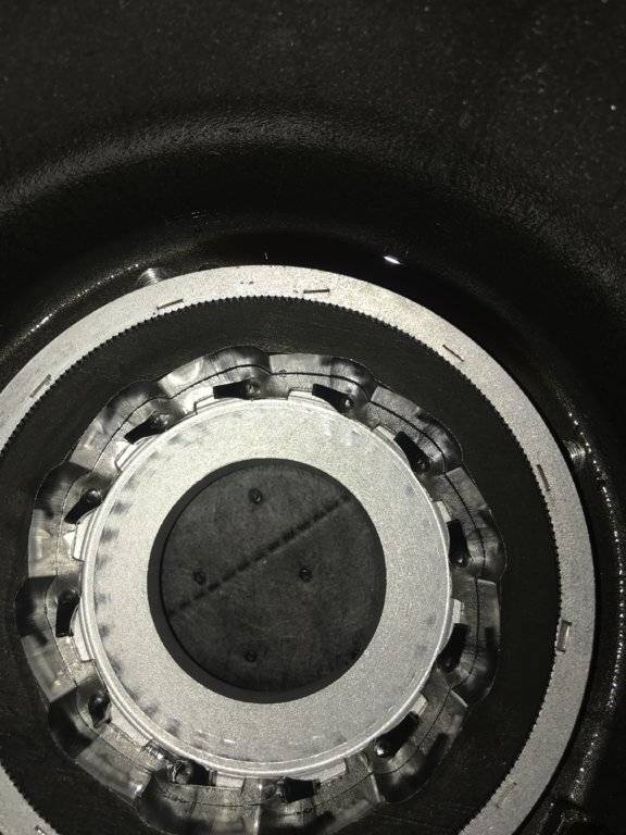

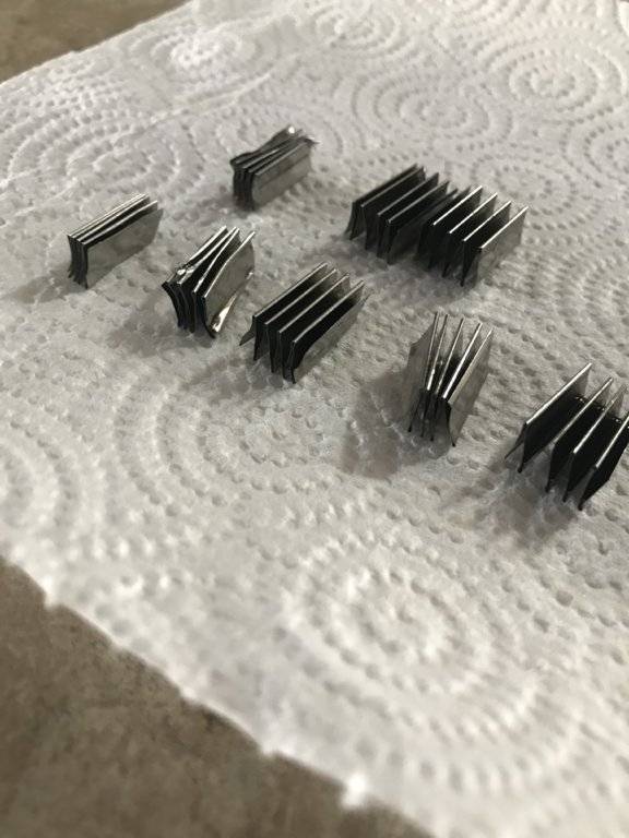

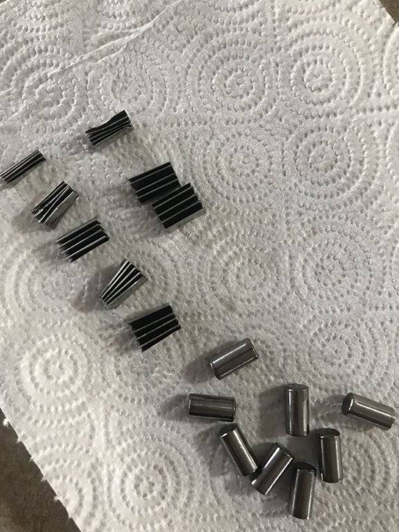

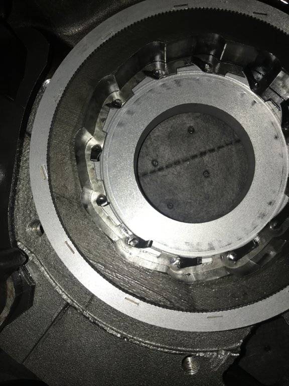

I pulled apart the sprang and my finding are in the pictures below. Its harder to tell in the picture but some of the teeth on the spring retainer seem to have become misaligned. Also some of the springs have become distorted.
You need a new sprag, I would buy a bolt in one yes they are more money and require more effort to install but 727 cases are not laying around like gravel anymore.
