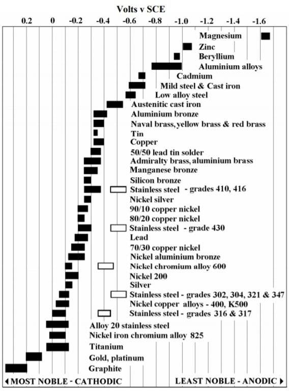

It's very simple to keep the aluminum radiators healthy and lasting a very long time. Buy some pure zinc plates and drop one in the top radiator tank. It will desolve, protecting the radiator. It's too big to get sucked into the top hose and even if it does, the thermostat will stop it from getting into the pump and it will still do its job. The only other two metals are Beryllium (poisonous) and manganese (flammable).

Yes, I used a zinc anode to good effect w my second aluminum radiator, the one made in Chicago. It worked well, and I even had fashioned a nice box shroud from angle aluminum which did what shrouds should. But there was NO repairing it alas, after that damned Infinity rear end got into it. Admittedly, copper would be difficult to fix too.
Zinc anodes do best when attached to your ground. Are you sure you're not thinking of MAGNESIUM as the "flammable" metal. Yes, it sure as **** is, even in a glycol solution! Manganese will oxidize, I concede, but I don't think its that reactive.
