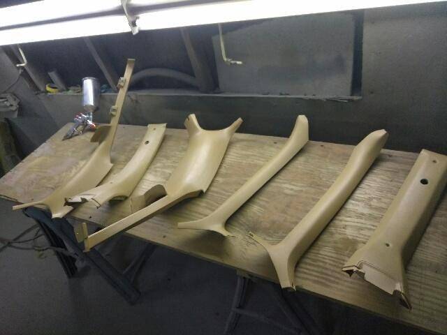

Since I was so excited to get some picks back from the painter I felt compelled to post them. He has promised it is all ready when I get back next Friday.

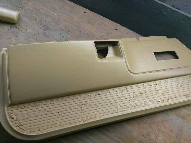

In keeping with any good resto, what started a quick driver quality pint became a full strip with jams and interior surfaces etc..

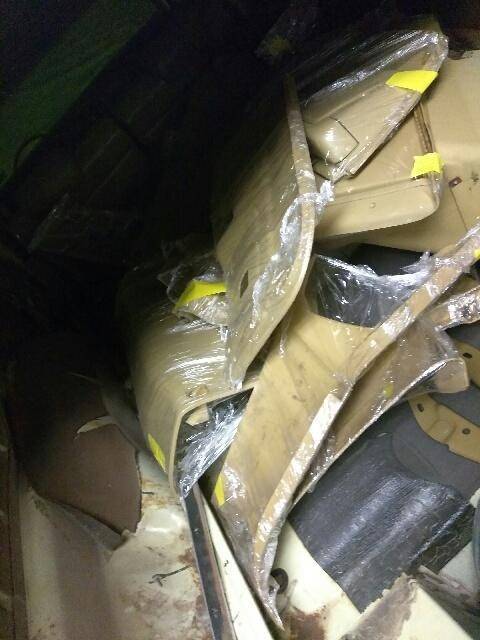

Here are the interior vinyl pieces, painted and then carefully wrapped and packed back in the car.
View attachment 116879 View attachment 116880 View attachment 116881
Did you use vinyl spray rattle paint cans?

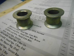

Your part number is for the metal ones.
They switched a year or two later to nylon.
I was referring only to the nylon ones.
Arizona Parts has the metal ones in stock.
Also, I believe Cee body Bob is parting out a Formal.
74 Only...they changed to plastic in 75.
I'm not thrilled with the metal on metal contact.
I'll go with plastic ones.

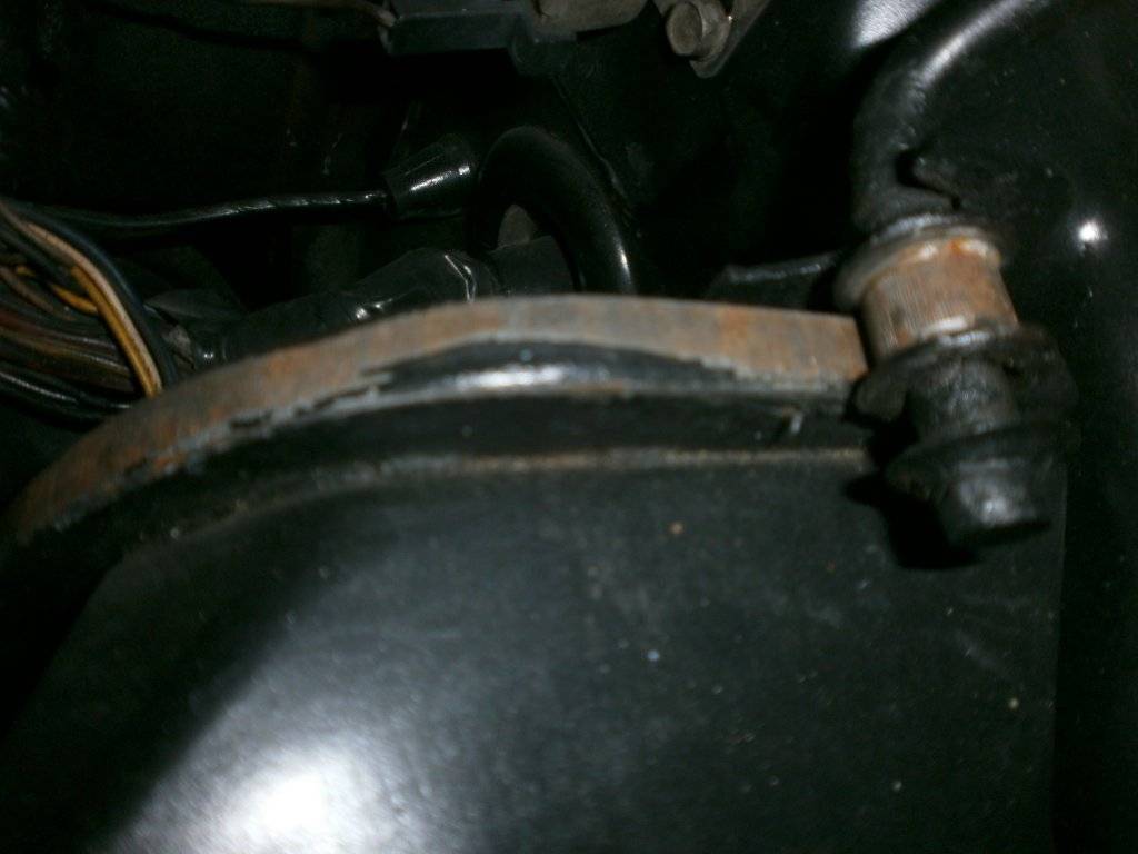

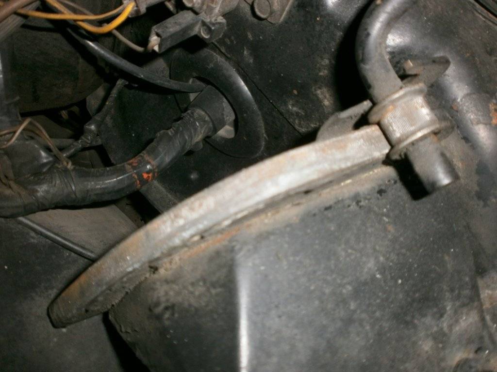

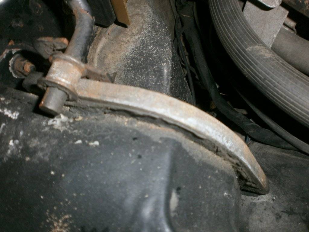

On 74s the tracks are ribbed too. They work better that the sliders in my opinion. Cantflip, can you get a pic and show the full assembly with the ribbed tracks?
I greased the tracks on my 78 NYB and can close the hood with one finger.
Theyre interchangeable?
Both. I got a quart of vinyl paint for the painter to shoot the removable parts and I got a spray can for some fixed parts I am not removing. I did the same with the lacquer for the metal. A bit of both. The paint store convinced me to try a preval sprayer rather than a rattle can so I bought one of those and I will try one of the quarts through that.

My first '76 needed a replacement slider. I found a set of rollers and it was a simple swap.
I later found a set of sliders and went back to them.

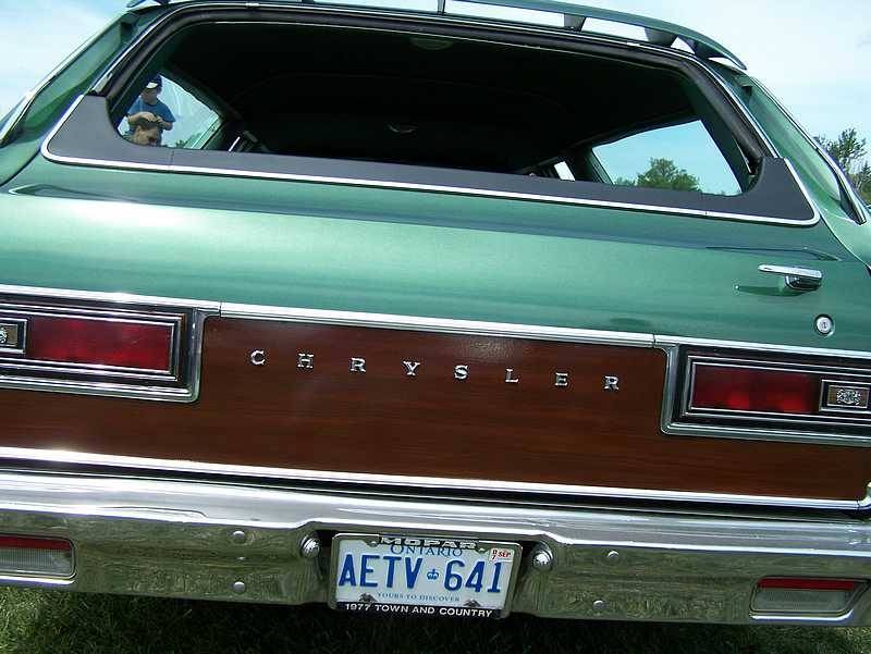

The gray, faded woodgrain can be somewhat resurrected using some ATF on a rag. Then you will have the grain color or really close to it...Mopar grain got dark as it aged and then faded to white. Don't use the instrument panel or roof rack, they were different grains (lighter). I wound up painting my woodgrain on. I used "mahogany" stain as it was the closest match I found to the brochure pics:
Sorry, I took a bunch of pics, but between the poor lighting and flash... these are the best I could do. Mr C is right, the track has a knurled surface... I assume to keep the wheels turning and prevent flat spots. BTW, thanks... they could use a little grease to keep them clean.

I taught myself how to do it. I had regrained the car once and found that the aftermarket Di-Noc was wanting...lots of shrinkage and associated wrinkling a year after application. Since I was spending the $$$ restoring the car I resolved myself to a woodgrain solution that would last forever.
I found a stain that works on metal (ZAR) and bought a sheet of steel, primered it, rolled it to match the bulge in the side of my car, and then practiced with a graining tool until I felt confident to grain the primered "canvas" that was the car. Once the stain was how I wanted it, I cleared over it.
I don't have many pics of the graining...most people are shocked that I did it myself. I'm happy with the result.

I can vouch for Mr C's painting skills... that woodgrain blows my mind though. I know it has been done for many years (decades) but to see results like that on such a big exterior area is amazing to me.

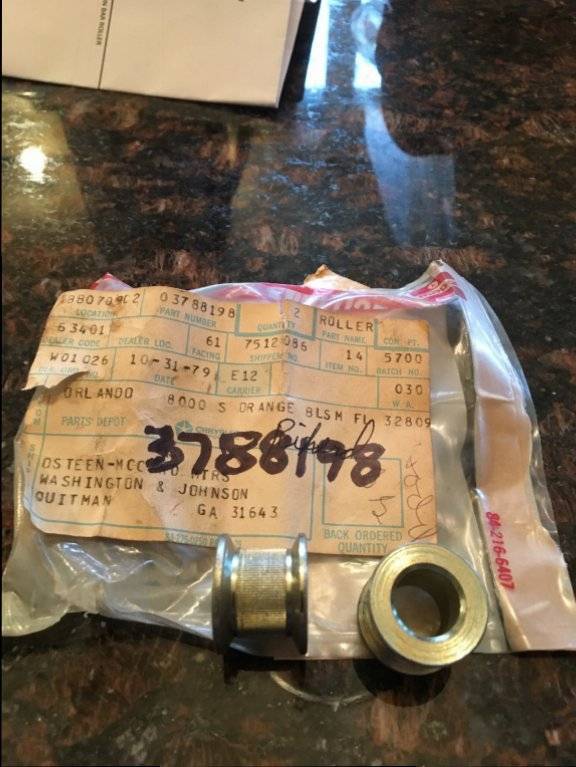

Got my NOS hood hinge glides today. They are metal. The metal is knurled for the record. I will put them in tonight and do a comparison
