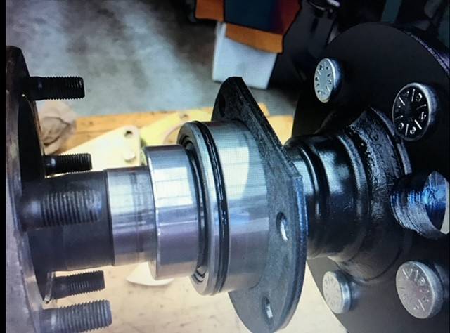

Regarding the Green bearing; did you keep the axle tube seals? I have the kit and it didn't come with the axle tube seals ... i'm thinking they are not needed and have read that sometimes they are even in the way.Yes, I completely agree. That's why I added "if they hold up" in my post. I feel they're a great option for most of us on here. I knew of them before they were required for my new brakes, I just never heard anyone's opinion of them or how they hold up in our cars. At this time I think they're awesome, when I finish the car (hopefully summer '25) and really start putting the miles on it (I probably only have a dozen miles on it), I hope they don't fail. Here's a picture of one of them on the axle. They feel like a solid, high quality bearing.
