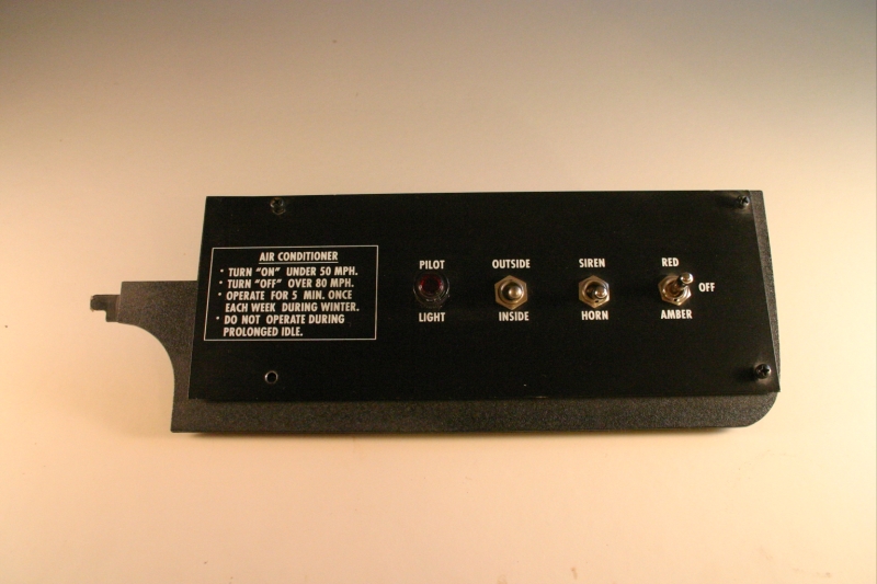

I've noticed some cars (mostly police) have an A/C cutoff below the dash. I'm just curious why this was needed. In Polaras and other models, did the A/C not shut off when the "OFF" button was pressed (like in Chryslers)?

Hey I saw that on a '77 catalina taxi I had. What WAS that all about?
I installed a cut off switch in the 73 Barracuda I had way back when... The reason I did it was because there were no fresh air vents in the car. It was A/C on or nothing. I would switch the A/C on and turn off the compressor so I would have fresh air flowing in the car without it being cooled. Great for night driving (I used to do a lot of that) with the windows down.
In 69 the CHP just added a note on their switch panel.

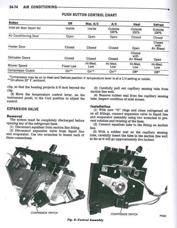

C bodies at least in 1973 always had the compressor running even if the a/c was off. It was a really stupid move given the short life of Chrysler a/c systems already. Their concern was about fogging the windshield under some driving conditions if moisture was accumulated in the evaporator and suddenly the driver is unable to see when they turn on the defroster for better visibility. The better solution to this concern was having the switch from previous model years (mounted on the outside of the heater/ac housing) that cycled the compressor on for a minute or so after each restart and then shutting if off. I suspect it was a stupid cost savings to eliminate that switch and go to the always on solution. Just mount a toggle switch, perhaps on the steering column lower cover, with the wires intersecting the wire lead to the compressor and problem solved.

If you look at the control chart below, you'll see that the compressor is only shut off when the "HEAT" function is engaged and the temp slider is moved enough to open the compressor cutoff switch (also shown on p. 24-74 below). The OFF button somehow renders the compressor switch useless.
In OFF, it says [compressor] "On above 30*F ambient."

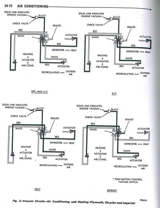

So, in theory, a temp sensor somewhere is really switching the compressor. BUT, per the wiring diagram above, I don't see any other switch. It looks like the clutch power is routed from the main control head to the blower relay. I'm stumped...
