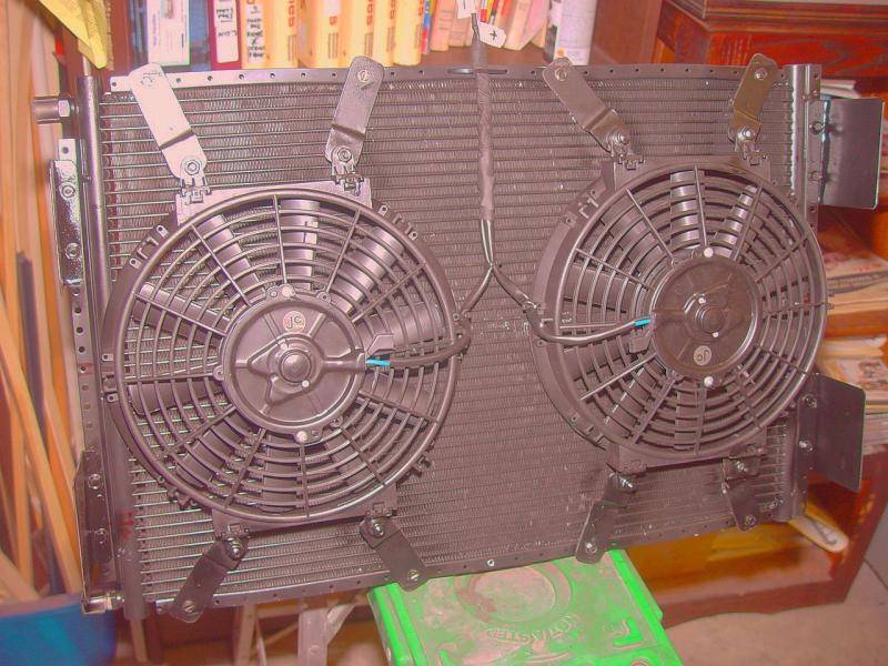

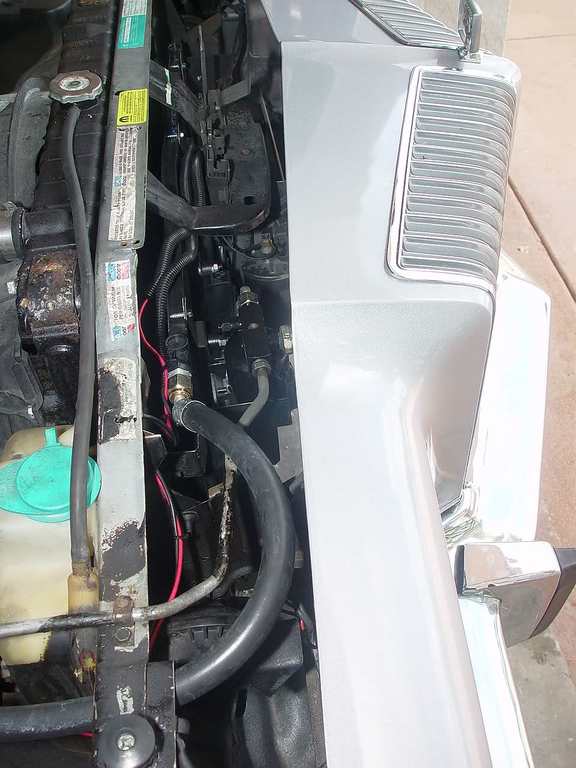

Spent two days installing the condenser and doing the wiring. Measurements were on the money.
View from the top.
Tight! Good thing I went with two fans to clear the center support and the headlight motor.
Just a 1/8" clearance.
Relocated the dryer to where the vapor canister used to be.
You can also see the relay for the fans and the wiring.
Viiw from underneath.
Headlight motor and upright support bracket just clears by an 1/8th of an inch!
The brackets mounted to the condenser are way over sized. I wanted to make sure I had plenty of adjustibility. My brackets lined up perfectly with the factory condenser brackets.

Some photos of the final and complete install:
Great work. Those hoses look very good too! Did they make all new parts for the hoses? It looks like the metal fittings on the end of the hoses are brand new too?
Yes, he made the new hoses with new fittings. My only gripe is he and anyone else in the county doesn't have the tools to do hard plumbing (tubing).
