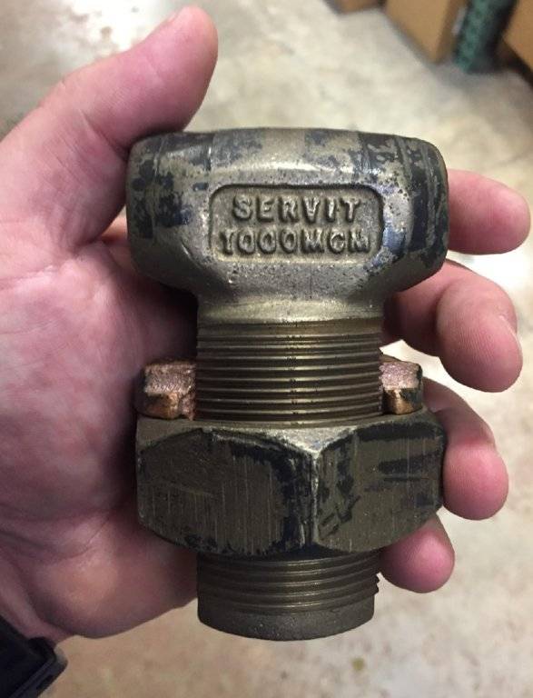

For myself (and probably at least one other),you speak in terms foreign to me. What in the hell is a split bolt? My understanding of a split bolt is one that broke and goes in the scrap bucket.
Pictures also would be beneficial for this hard-headed Norwegian...
Like so.
I used one of those to fix a power line
Installed and taped up more than I care to remember in this size...
THOSE are just a trifle oversized for my purposes. One can buy "kerneys" meant for #6-10 AWG at most rip-off DIY stores. I too learned to tape them up, first w rubber, then friction cloth, and last in 3M vinyl some decades back. I use genuine Scotchlocks for wire nuts on some of my automotive joints also. I ALWAYS make junctions in my cars which can be cleanly disassembled.
If folks REALLY need a pic of this trifling job, I suppose I can get one after sundown....... Just remember, increase that wire by 1 standard size & pick up about .75V for your dash circuits. That makes a difference at times.
