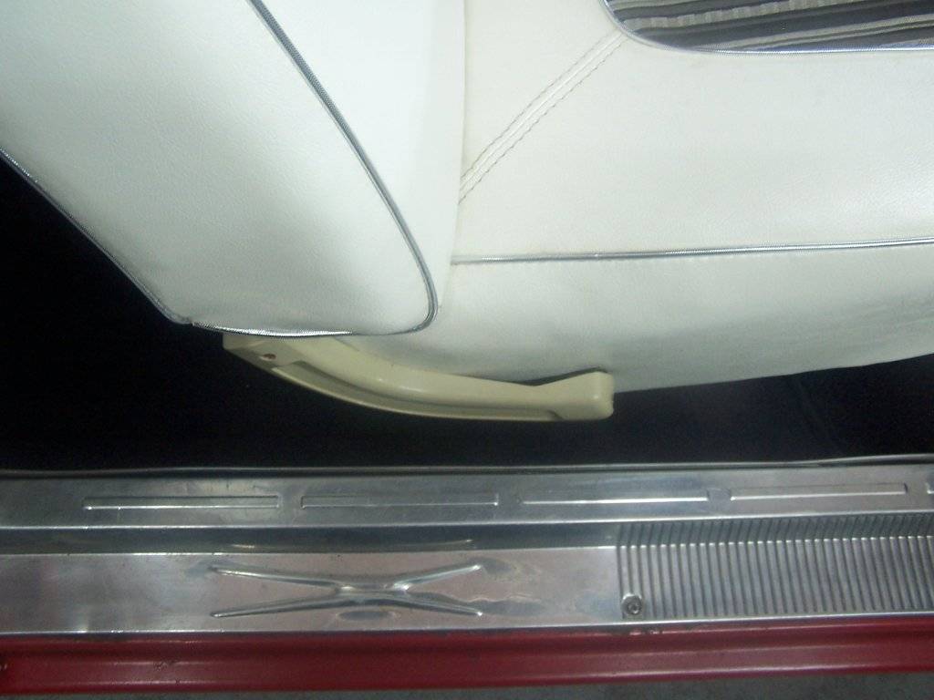

Another concern I have is, there is only about 1" clearance on the outside of the seat on both sides and the seat back hinge cover being plastic if that would be a problem.

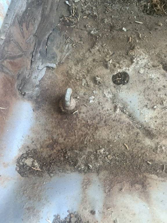

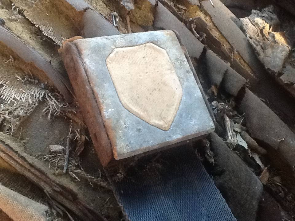

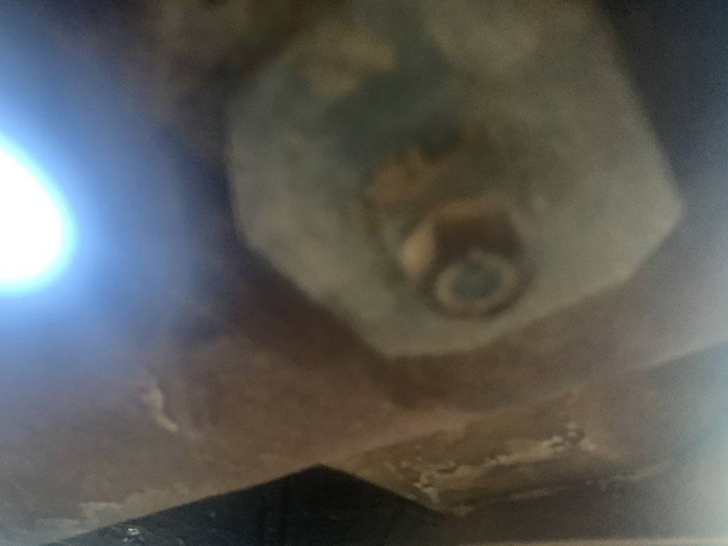

For my 61 Plymouths (which are rare with factory belts) I use 62,63,64 Chrysler NY,300,Newport, and 63/64 dodge 880 belts.
These models have the same floorboards with big square anchors underneath. The eye hook up top with the clip on style belt to keep it vintage looking.
These pics are from 63 300.

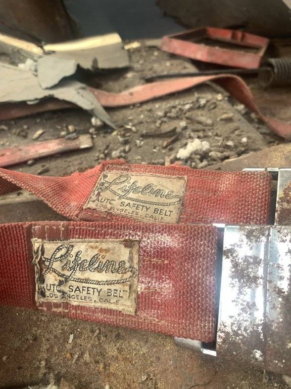

Many of the earlier belts were of a more open weave fabric, unlike the stiffer/solid belts of the 1960s. With that "aircraft style" chromed buckle, too.
Yea, I look at the 58 year old open weave belts in my Imperial and wonder " are they really going to do any good?"
