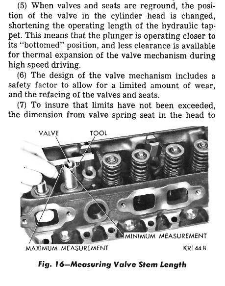

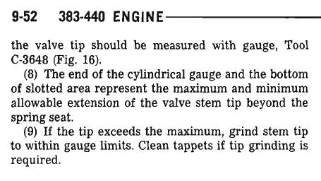

Ya know with this post and many other cam, valve train related posts I have never seen anyone refer to the FSM about valve stem height, or "Valve stem length".
When I foolishly did my 440 6bbl heads I got 'Chevy'fied' by the machine shop and as a result suffered the "during high speed driving" aspect.
Live & Learn...
