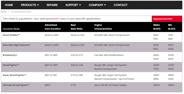

Your gear ratio will be a factor here. Here's a chart from TCI

You cam choice is also a factor, you need to match the stall speed to the torque range of the cam. On the spec sheet for the cam, there is a set of numbers showing the low end and top end for the cam. You want the stall speed to be slightly above the low end for the cam or you will have a big dead spot on the low end with the engine potentially stalling out. Your typical street cam will need a stall speed of about 2500 rpms. A full on race came will typically be closer to 3500 rpms or higher. As noted the gear ratios are also a factor in getting a good launch. A gear ratio matched to the peak torque range of the cam on a 1/4 mile track is going to be pretty much useless on the street.
