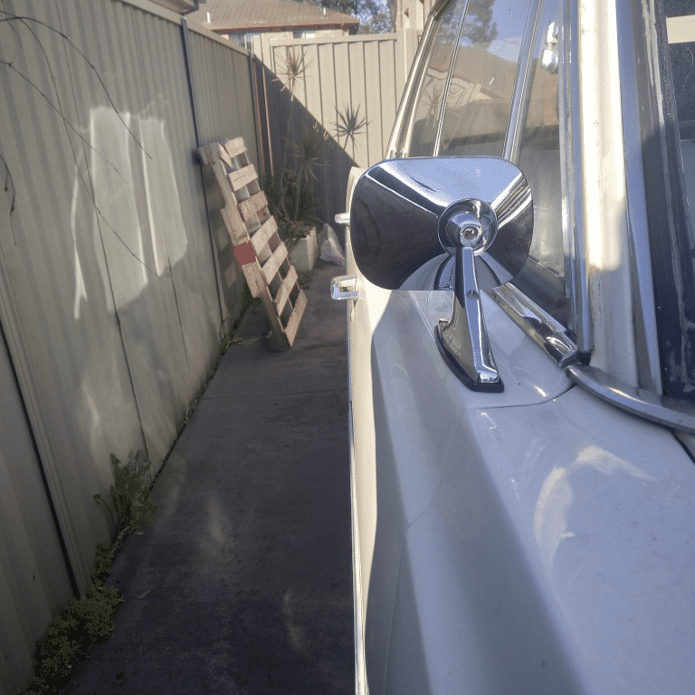

Installed some nice rectangular mirrors on my 67 Fury/Dodge but the visibility still kinda sucks and I think I know why - on newer cars, factory mirrors actually jut out a bit to the side of the car. On these, the stock mirrors are still within the confines of the total width of the car

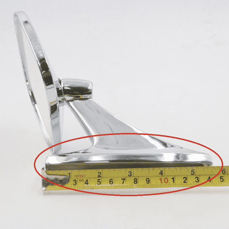

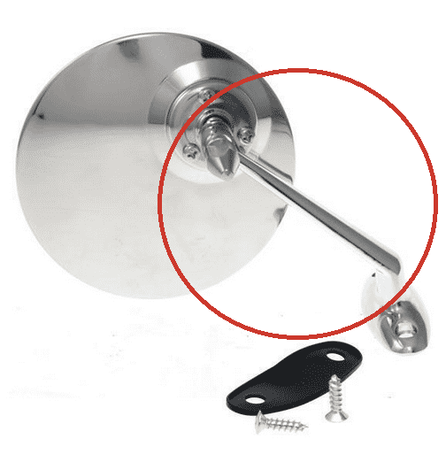

The angle doesn't really show it as well as I wanted it to, but there's about 1/2 to 1 inch between the outer edge of the mirror, and the door handles. Does anyone know of any square mirrors that have an angled arm? Something like below, but with a squared/rectangular mirror like above, and with a long mounting base like in the below second pic?

I only want the mirror to stick out no more than the door handles, those actually poke out quite a bit so as long as the mirrors don't extend further than those I'm happy.

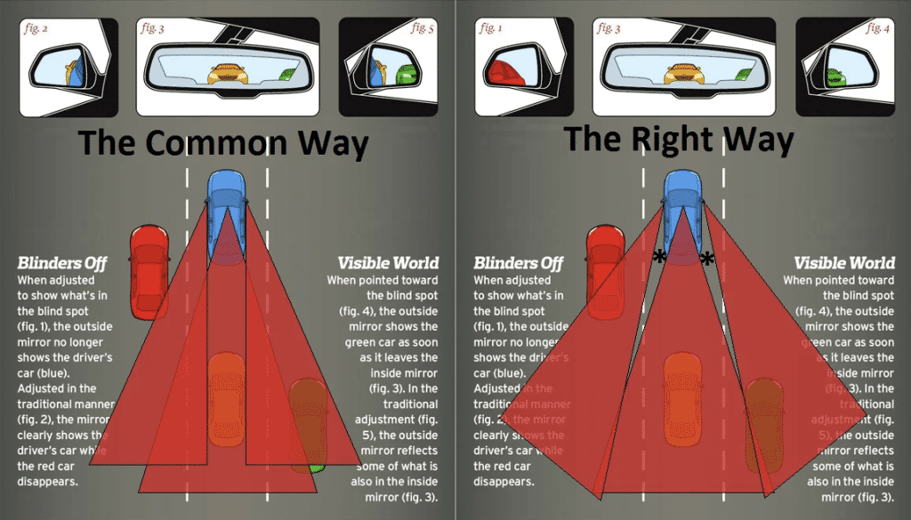

I've angled the mirrors so that they cover my blind spots as per this diagram, it works great with flat mirrors when reversing because you just need to move your head around until you can see the side of the car, and it doesn't throw off depth perception like convex mirrors do.
My main issue is that no matter how the mirrors are mounted, because of the position of the factory (and aftermarket) mirrors, they can never actually see down the sides of the car which is rather unfortunate, but would be resolved with an angled mount. Wonder if I could 3D print an adapter to tilt it out more...
