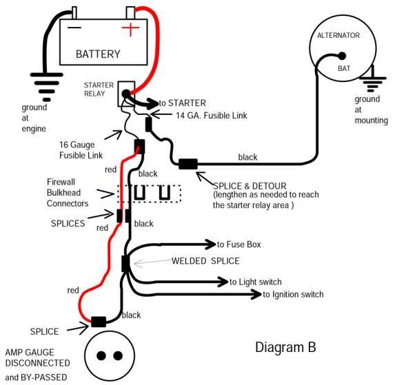

Accompanying that would be a simple ammeter bypass like the so called "Mad" conversion

To avoid any nuclear meltdowns,I run and extra 12 gauge wire from the BATT stud at the alternator with a fusible link to the BATT stud at starter relay.That takes 50% of the load away from the ammeter gauge.

No. The wiring in your car is likely rated for a 55 amp alternator. You would need to rewire the the charge circuit and do an ammeter bypass to start with. If you put a 95 amp alternator in your car, it will have an electrical fire.
What? Simply swapping in a higher capacity alternator for one rated closer to stock, without any other changes to vehicle loading, will not increase any current draw through the stock charge circuit. Will not cause an electrical fire in it of itself. Will NOT require an ammeter by-pass, it's shunted in '73. The main benefit to a larger capacity alternator, with stock loading, is more available current at engine idle speeds over stock rated alts, meaning less current stress to the charge circuit components/connections at idle.
By ’73, C-body ammeters are externally shunted with all 8ga under hood charge circuit wiring stock.

There is a lot of misinformation about this charging system out there. Here is some info I posted about the Chrysler charging system a while back, primarily focused on the non-shunted ammeter versions and load placement and other common issues. The video targets ’70 and up B&E bodies but the functionality is basically the same as the earlier C-bodies and the later shunted C-body ammeter system. Any added loads will need to go on the alternator side of the ammeter shunt wire to maintain an accurate ammeter.
