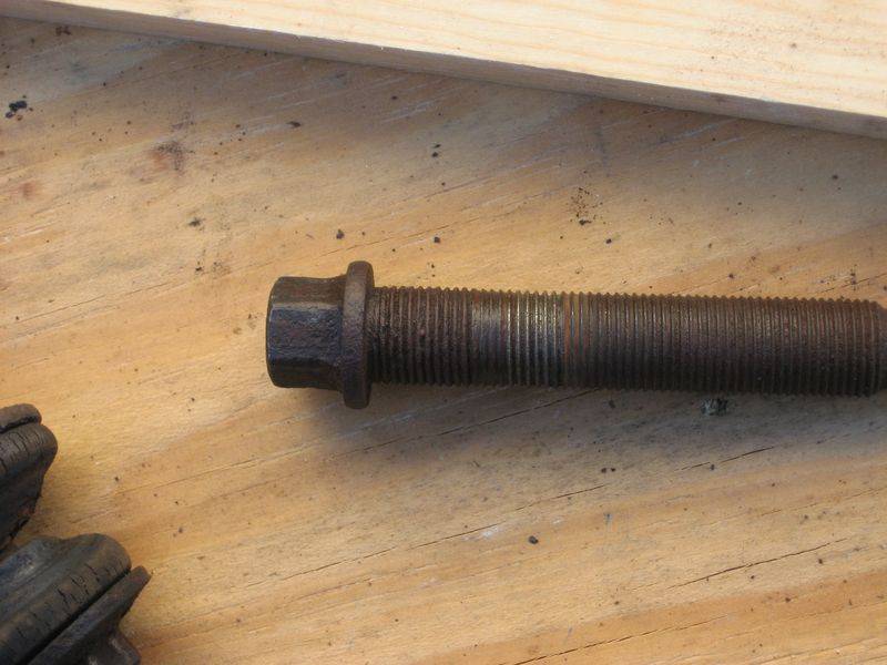

As mentioned in my progress thread, the reason my passenger side was sagging and not adjusting properly seems to be that the adjuster bolt was rusty, seized, and the threads were worn.
I chased the threads with some wire I had lying around (my proper thread chase was at my house, and I was working on the car at my brother's), added some oil, and threaded it back in. It adjusted much better, and the car is now properly adjusted.

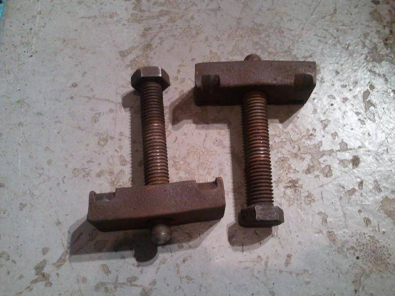

That's interesting. Not only is that bolt different, but the adjuster nut-thingie (that's a technical term of art) is different. I didn't take any pictures of this up close, but if you look at this pic, you can see that the ends of the adjuster are semi-circular, and ride in a cupped slot on the control arm.
I guess that means the parts are different from C-Body to Imperial.
Looks like the bolts were replaced. Maybe Dematt can look under his Imperial to confirm whether these bolts look correct For the torsion bar adjusters. The pic Stan posted looks like the ones that should have been there.
Maybe, but the bolt ends are rounded off on the nose like the ones in the eBay listing. I would be curious to see what another set looks like, especially since the piece they thread into looks to be different, too.

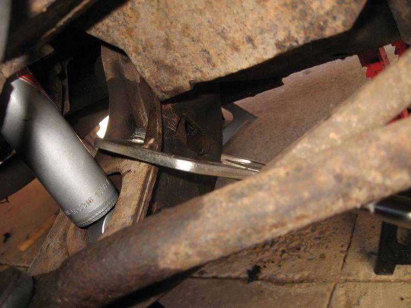

im the same spot, just loosened those bad boys up. mine look like the pic commando posted on a 68 fury. but the mopar tech article said its a 3/4,, and mine are 13/16th or 15/16 I forget, but it wasn't 3/4... anyone ?
driver side loosened up really easy, passenger side fought me. I bet its worn out like your pic :/

I checked a few of the aftermarket places earlier, and I think one of them was PST. Nobody had them. You probably have or had a leaking power steering system at some point. I think that's what kept the driver's side so well lubed up on my car!
