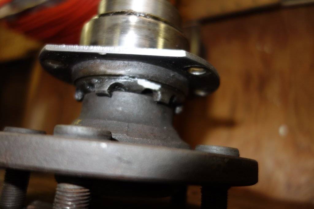

Pictures of the tangs would help.

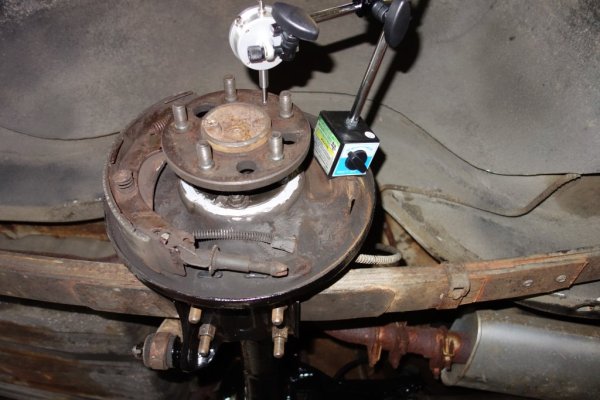

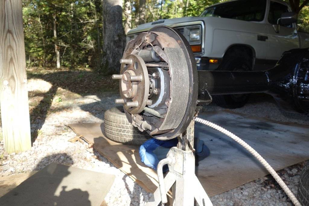

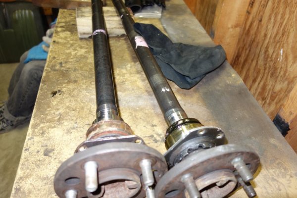

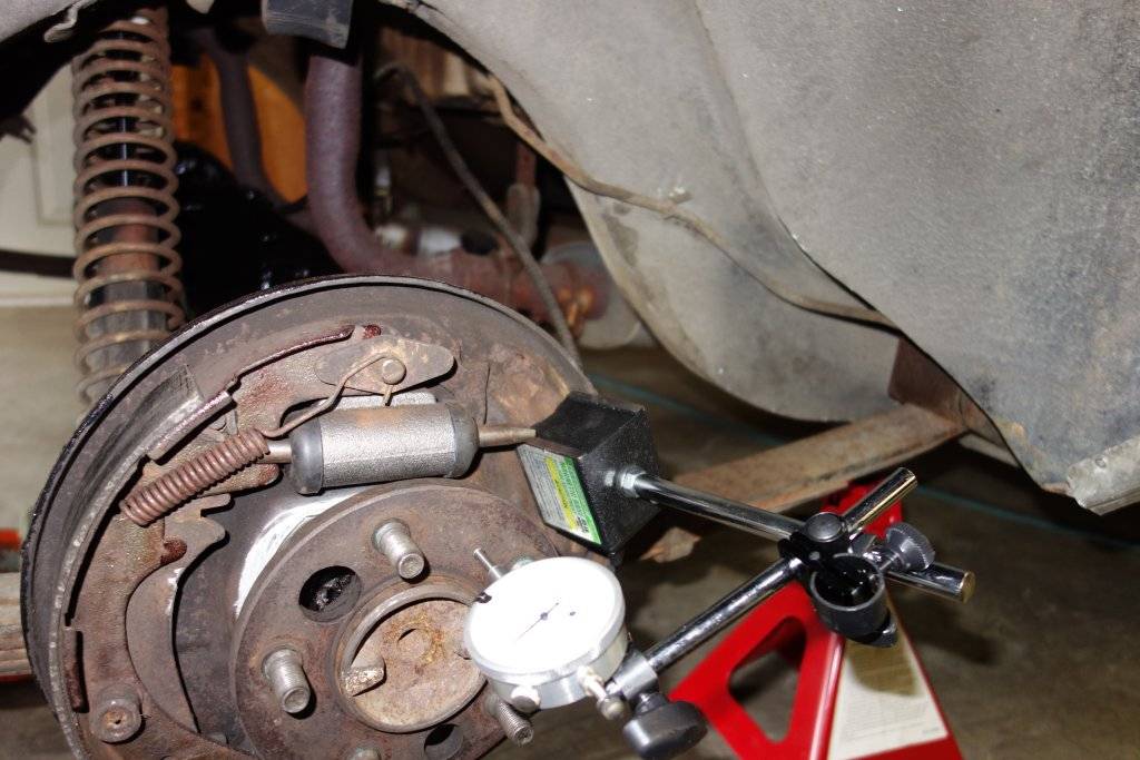

Normal on my 1970 Fury Convertible 8.75 rear

Your inner tangs are on the inside and mine were on the outside. I took a heavy punch and bent them back in and now seems to work but adjuster is way out. At least over a 1/4 inch. I rechecked bearings and they were pressed in right place.

I'll get a picture

Yes. Done before. Axle was super sloppy, didn't measure, and noisy. Got timkens pressed on both axles. Set right Axle at .018. spun it in air. Ok. Took a 20 mile ride and axle seal was leaking. Took wheel off and end play was at least 1/2". Adjuster lock was bent out and adjuster backed in. Reset to .018. adjuster at least 5 threads out. Put 2 locks on it and bent tangs back in and after 50 miles is still ok. PS. Mechanic for 35 years. Just never experienced this or ever seen an adjuster so bent out.

Both wheels off the ground. Following service manual.

I have .018 after adjusting out almost all the way.
