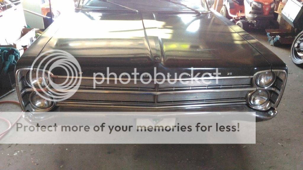

Hi all, I just acquired a 1967 Fury III 4dr hardtop, (stole it for 1300CAD at auction).
I've owned a number of Mopars over the years including a number of Dodge trucks and even a Scamp with a slant 6, but this is my first C body.

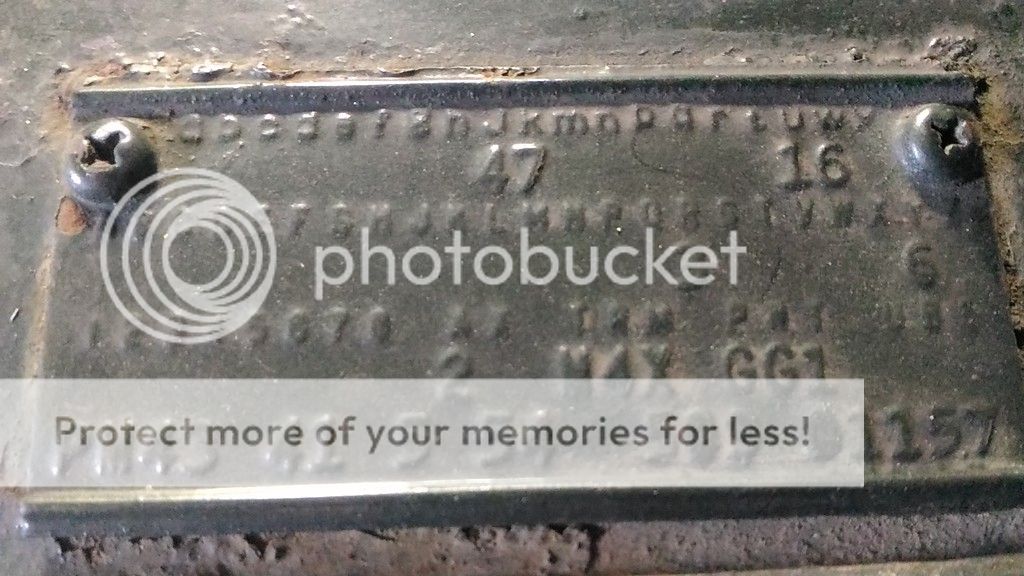

I have a few questions, mostly motor related as it appears to be a Poly 318, however the engine code letter of the VIN is F and there's no mention of it in the 67 Plymouth workshop manual. Does anyone have any more info?

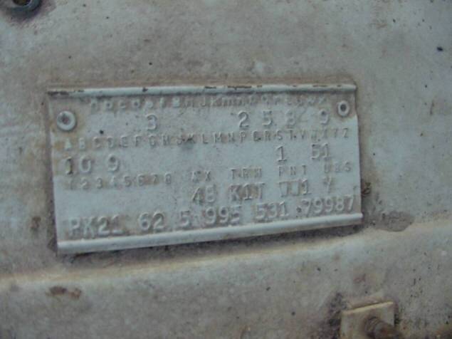

Post a pic of the fender tag, should be mounted on the driver side fender and look like the pic below. Info on engine, trans should be revealed by that as well as other options.

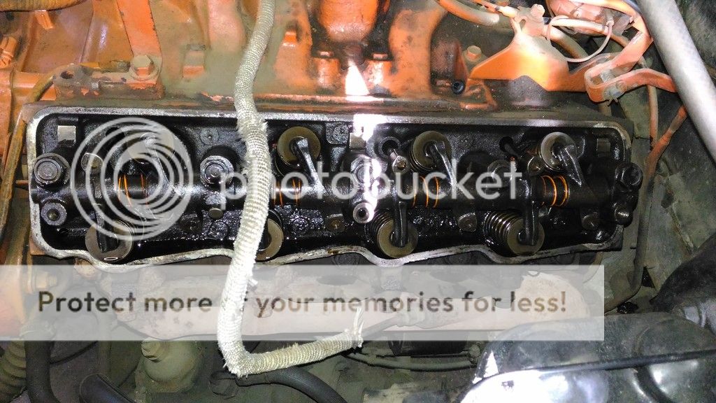

Welcome. Nice car! An engine pic will clear up the poly question. Please post a few. Use the highest quality gas you can buy, regardless of engine. Yes, performance parts are available. Google is your friend for much of the other questions you may have.

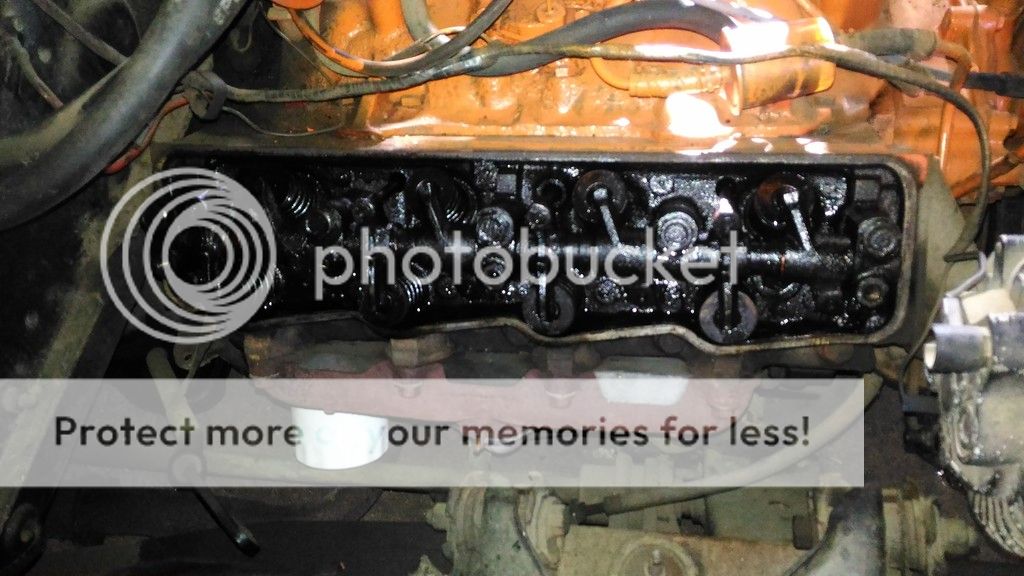

A bit puzzled today, I pulled the rocker covers to check the valve clearances on my new (to me) Poly 318, and surprise! no adjusters.
So next question is, are the adjusters someplace else? or do I have hydraulic lifters?
Checked the compressions too, most around 120-125 lowest 115 highest 130.
