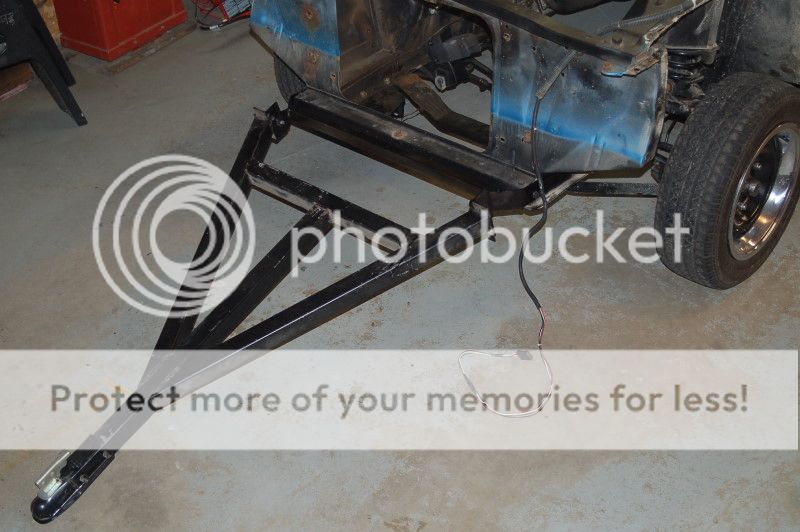

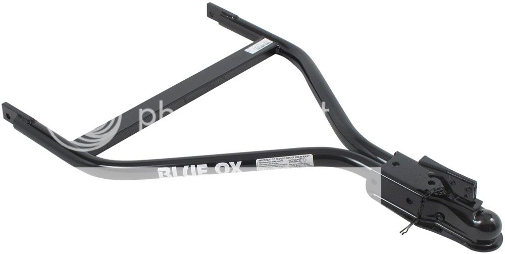

About 45 minutes on side roads, and with a 1/2 ton pickup.
And with a Tow bar, similar to below.
Boy take it nice and slow. I wish you could borrow my tow dolly. My worry would be the sway of the car because the front wheels needs to turn on thier own and then straighten back up. I know using my tow dolly on a car without a locking steering wheels can do some crazy things if you don't fix the wheel straight.
Do a test run around the block and go with plan B if it seems unsafe. Good luck.
I actually remember my dad towing a MGB home with one of those probably 30+ years ago but an MGB only weighs 2,000lb. I remember it was unnerving watching the steering wheel spin around when ever we went around a corner
That worries me aswell (the swaying), I plan to do it on a day with little to no traffic and good weather, plan to take it slow as possible. Worse comes to worse I'll go plan B, I'll do a shake down run, from where the car is stored to my house and see how that goes.
Nick
I have used a tow bar quite a few times. Only problem I ever had was towing a '75 Imperial without an engine or trans. Problem was whenever I would turn a corner the front wheels on the Imp. would turn with me, but not return straight because of the lack of weight on the front end.
