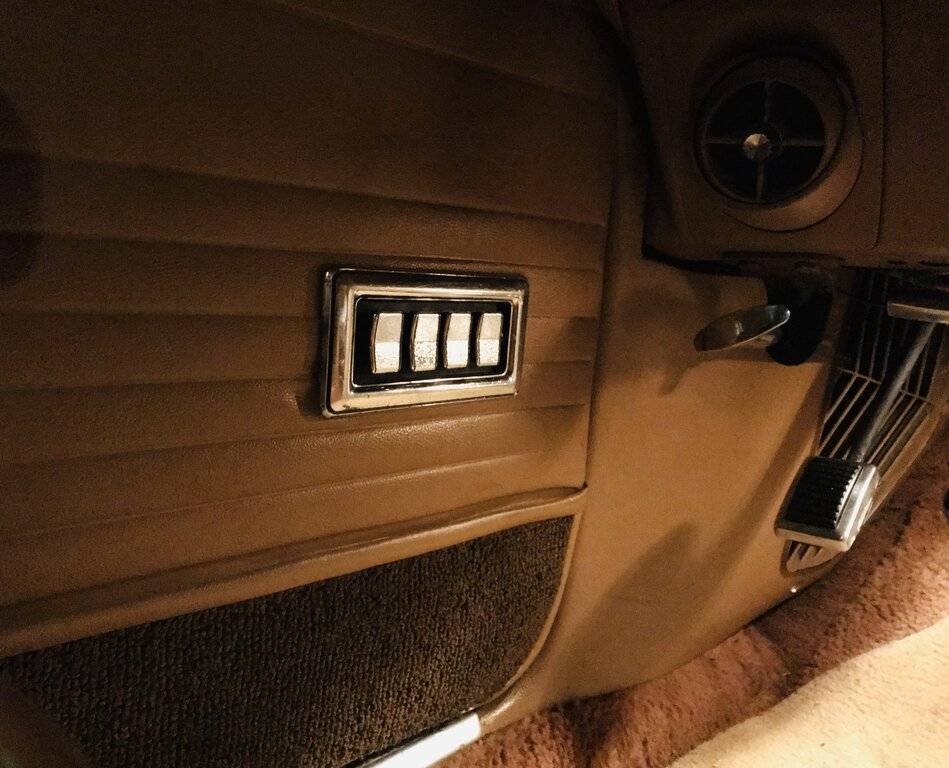

Driver door window switch is flopping around like the springs are shot and I have to play with it for window to work. Once a positive connection is made, window goes down and up fast so motor should be OK. The other windows work fine. Its not the wire connections since I hard wired each connection 20 years ago so they don't come loose. Anyone know how to fix just the switch mechanism? If not, does anyone have a master window control in very good condition? Thanks for your help.
I still rebuild the '69 and later PW switches. I USED to rebuild at least 5 sets per month, but with the fire in Paradise CA melting all of my parts, combined with the release of the Chinese repros, cut that back to maybe 2 sets per year. Because of that I quit buying up all the spares for parts. I still have enough to do a few though.
Classic Industries sells a repop switch now. Using one in my Charger 500, works great.
Big_John made a tutorial about how to make the switches relay-operated:
Power Window Relays, now with Power Vents
Helped me a great deal when I had similar problems.

Driver door window switch is flopping around like the springs are shot and I have to play with it for window to work. Once a positive connection is made, window goes down and up fast so motor should be OK. The other windows work fine. Its not the wire connections since I hard wired each connection 20 years ago so they don't come loose. Anyone know how to fix just the switch mechanism? If not, does anyone have a master window control in very good condition? Thanks for your help.View attachment 421950
call devin 530-520-7427 he can rebuild them, as well as clock, great person, he has one of mine now to repair,,,,, Greg
