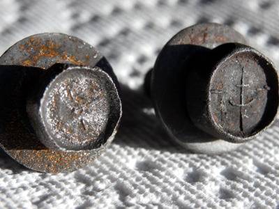

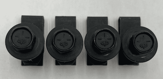

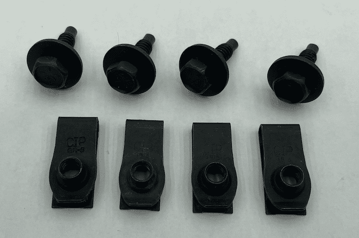

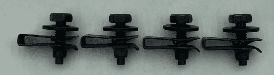

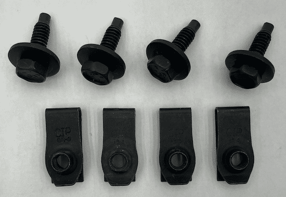

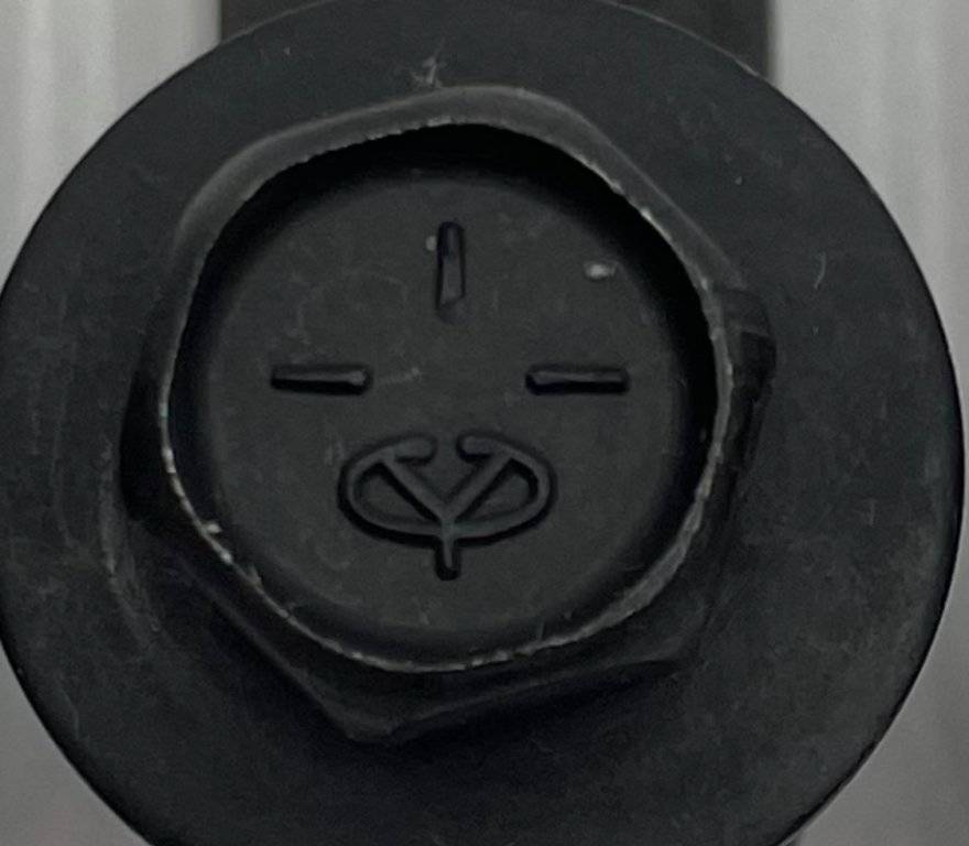

These are the nuts and bolts that mount my OEM fan shroud to the radiator. The nuts are stamped "CIP" with "GR-5" underneath. The bolt heads have crosshair dashes casted at the 9:00, 12:00, and 3:00 positions with some kind of a Y-ish symbol at the 6:00 position. Thread size/pitch is 1/4-20 NC and the bolt heads take a 7/16" 6-point hex socket. The washers are captive, they'll turn, but they won't go down the threads which is nice. Are these nuts and bolts the originals from the factory?

The three hash marks signify "Grade 5" temper. Five hashes would be "Grade 8". It would be reasonable to assume the "Gr 5" on the nut means the same. My guess is CIP is the supplier. I couldn't speak to the originality though.

For the record, that's the same hardware I just pulled off the very original front end of my Newport.
Looking at them, they ARE OEM fasteners, period. Appropriate for the noted location.
Reason I know this? No replacement "hardware store" bolt will normally have a captive washer on it. Nor the under-cut end of the threaded area (which is there fo aid in the bolt finding its hole and threads on the fast-paced assy line!). PLUS that black oxide, rust resistant coating on all of the pieces of the bolt.

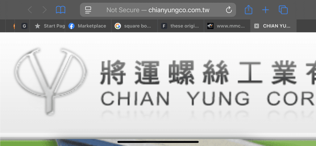

The pictured bolts and U-nuts were not originally equipped for a Chrysler vehicle of the 1970s, specifically 1973 Challenger.

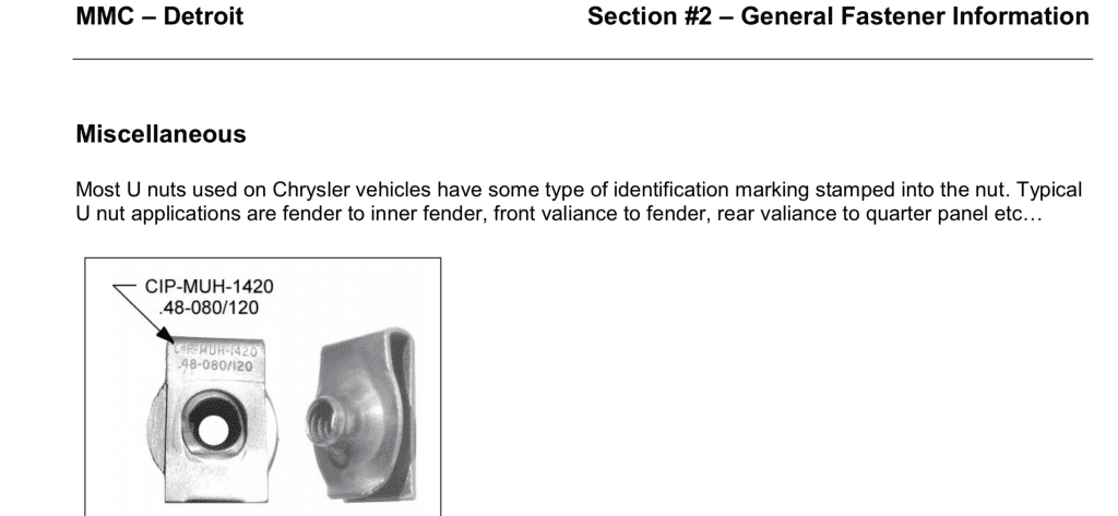

The U-nuts were made by CIP Fasteners, a defunct company now absorbed into ITW.
The bolts, or screws, with the washer were made by Chian Yung Corporation. The bolts are Grade 5.
The bolts are styled similar to original, as are the U-nuts, although the U-nuts are not specifically the same for the application.
Chian Yung was established in 1987, so the bolts aren’t original. Still curious about the U-nuts with the CIP markings as I saw CIP marked on a U-nut in the MMC Detroit literature.

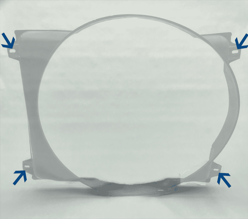

On a fuselage C-body at least, the shroud bolts go directly into the radiator support member which has captive rectangular nuts either welded or swaged in place. They are 1/4-28 I believe.
No U-nuts.
U-nuts are often used for sheet metal to sheet metal type assemblies, such as the inner fenders to outer fender.
