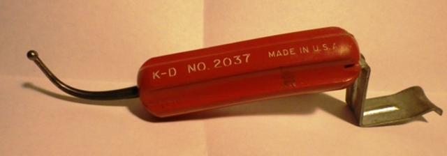

You need one of these to get the trim off. You may have to find one on Ebay though. Gearwrench (who own KD Tools) doesn't list it anymore.
You slide the hook under the trim and unhook the clips. It takes a little patience, but this is the best tool I've ever found to do the job.
