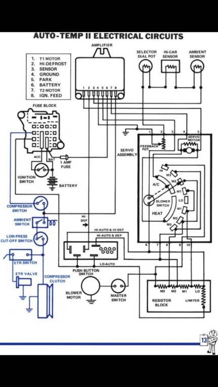

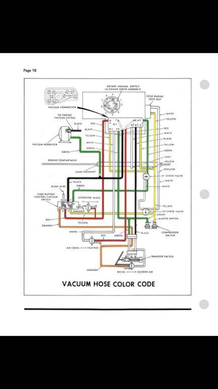

Happy Sunday! It's a super hot and humid day here today, which got me thinking about the 73 T&C's A/C system. It's AutoTemp II...and wow does it look complicated. I'm not well-versed in all things AC, but am hoping that you can steer me in the right direction.
I know I will not be using R12. It will be either R143a or Duracool. I will not be upgrading the compressor and condenser at this time.
I haven't even checked yet to see if the compressor turns on/clutch engages. I'm sure there are threads on AT2 overall that would give me much needed insight, but I can't find them.
I do have the FSM, but I guess what I'm looking for is if there have been discoveries made by other FCBO peeps that will make this process easier. Any guidance?

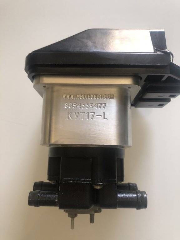

You are absolutely right: is not easy to diagnose or to fix ACC 2, if you don’t have experience. Today I think, only one handful of people in world really know the system. I’ve remanufacturing Servos for years and sold over 1700 in five continents so I know firsthand, how many “ mechanics “ have no clue about the system.
