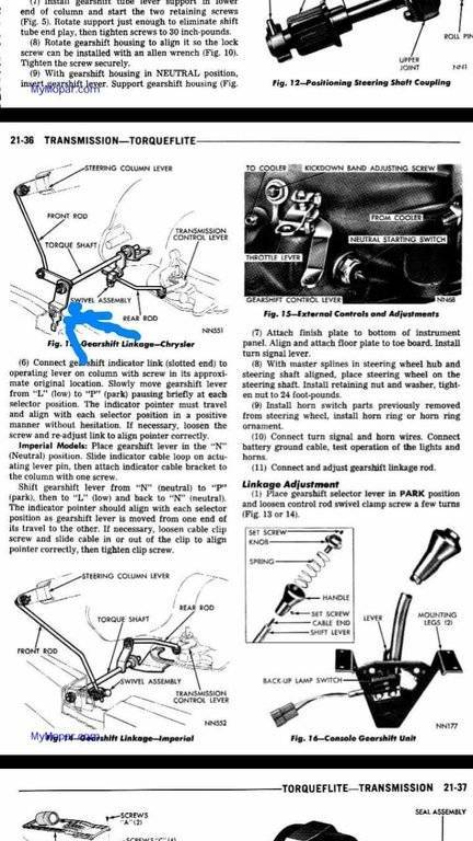

The piece that bolts to the frame rail. I found everything else.Not really, it's just a large tote full of miscellaneous linkage and bracketry so it'd be easier if you tell me which pieces. It's also in storage up in the mezzanine/crawl space above my shop and it can be hot up there.
