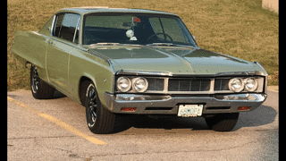

Hello to all...I have a 68 2dr Polara 383 4bbl still a ways to go of course . am looking for some help choosing a camshaft is a cruiser has stock motor runs great but want to add some pep
stock 4bbl and intake dual exhaust with H pipe stock cam pointless distributor want nice street cam like a 383 magnum cam dont want to go crazy ganna start with a camshaft upgrade
Thanks for some suggestions
