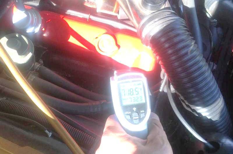

(pic was when it was 93F degrees outside running the old 195F thermo. (aftermkt temp gauge said 215F degrees)
Black smoke is bad, needs more heat as you know.
Where are you pointing the temp gun to show the 185? Should use the WP housing thermostat area.
Thanks for the additional information. Engine thermostat temp should not affect exhaust system "smoke".
Agree, black smoke is bad and indicative or an automatic choke not opening fully for some reason (vac break/choke pull-off needs adjusting or is not working, automatic choke thermostat is adjusted too rich or needs some tweaking leaner). Not to forget that the spark plugs are getting sooted-up, too. Might check the (metering rods, if an AVS) primary jets in the carb, too. And the air bleeds in/near the primary venturi cluster.

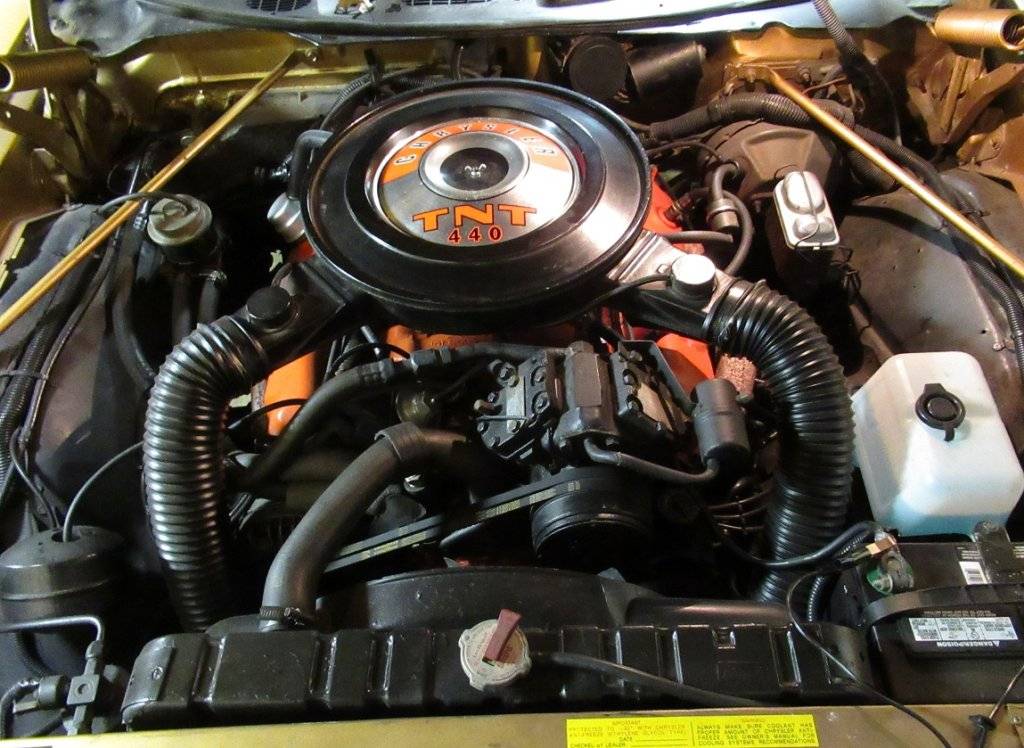

Interesting cold air intake which I presume isn't factory. If I may, what kind of tube is that and where did you get it?
The great Ebay wonderland. Some cheap rice burner cold intakes. I think they were 3" X 4ft but not sure. It was a long time ago. I think all old carb cars should have something like this. No more loss of power when fully heated up or too hot outside. Seems like a bump in power over 30mph due to forced air, but never had it tested, so maybe just my imagination.
If you do this, you'll need to weld the inlets to the frame, weld fencing inside the inlets and slightly play around with your carb settings. Even so, you'll get more crap in the filter housing, so I'm cleaning it out every 2000 miles. Odd that there hasn't been any problems in rainstorms.
