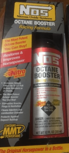

I used to use this stuff in my modified turbo MR2 and it allowed me to run higher boost and slightly more advanced timing before onset of knock. But I just found a site that did testing on a bunch of boosters and this only came in 5th. https://nitrous.com.au/octane-booster-shootout/
