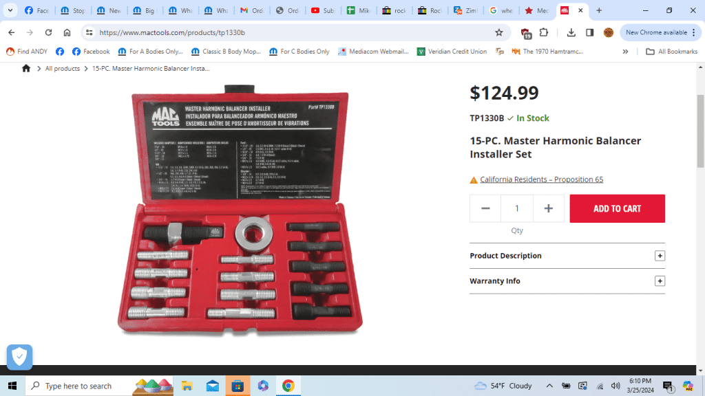

Anyone remember the pressing on of a big block harmonic damper?? I am building an install tool and want to use 3/8 rod to pull. But, if they are very tight, I will have to up the size. Prob heat the damper a taste to help and will use a bit of never seize....but am curious how tough you have found the pressing job. thanks

I sold a lot of these when I was in business. Over kill for one install but you get the idea. Press them on. Don't beat them on or draw them in with the balancer. bolt.
