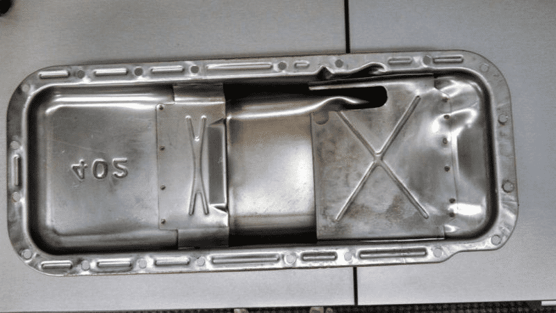

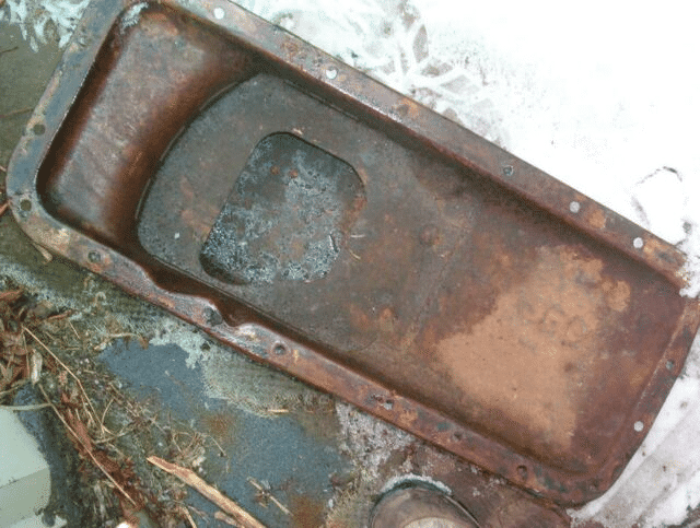

I've never seen a template for making the baffles, but I have seen several different versions of the baffles. I would just try to copy the one you want.
I've seen a few of these.
Then there's this style and I think would be harder to make.
Another style, probably the easiest to copy and will do the job.

Simple baffles like the ones in Big John's bottom picture are easy to make from some sheet steel and snips. Tack them in leaving room for last drain back but not so much that oil gushes rearward or forward quickly.
I have one like the middle picture, factory, and not a lot went into it. Three or four tacks hold it in place.
I have one like the bottom one came with the engine out of a 74 Fury 400-2bbl. Meanwhile my stock 70 383 HP has no nothing and holds a quart less.

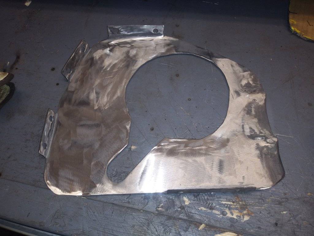

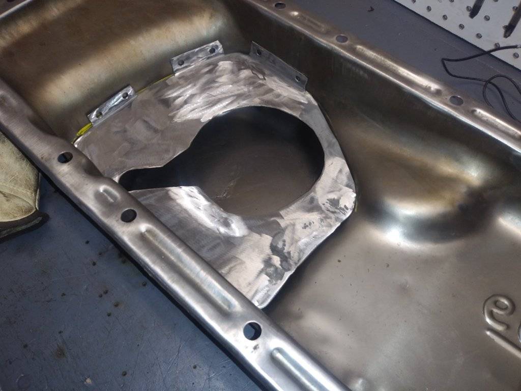

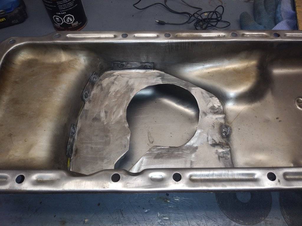

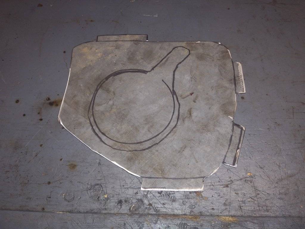

So, here's what I came up with.
I haven't tacked it in yet. I'll spend some more time tomorrow on shaping the drain back notches a little more.
