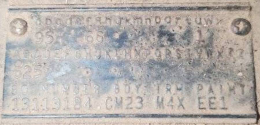

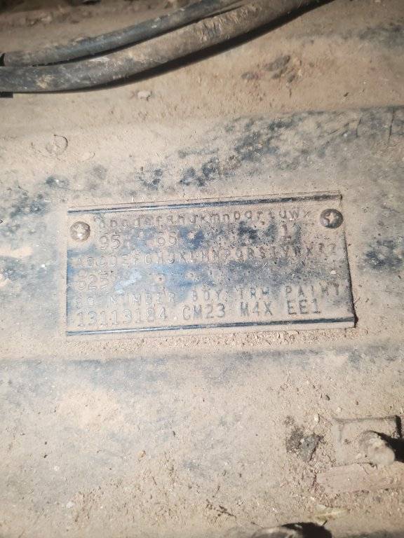

Feb 1, 2025 #1 SittingSince85 New Member Joined Oct 17, 2023 Messages 13 Reaction score 12 Location Mid South On a 1966 Chrysler 300 with either a 383 or a 413
Feb 1, 2025 #2 69CoronetRT Senior Member Joined Feb 3, 2013 Messages 3,061 Reaction score 4,380 Location Iowa AB/62 = 383-4
Feb 1, 2025 #3 4 413 Senior Member Joined Jan 28, 2019 Messages 2,516 Reaction score 2,920 Location NW USA 1966 was the first year for the 440. The 413 was gone, no more 413 after 1965 in passenger cars. Let's leave the industrial and trucks out of this Passenger car question.
Feb 1, 2025 #4 C CBODY67 Old Man with a Hat Joined Mar 27, 2011 Messages 12,599 Reaction score 8,794 The other situation is that the fronts of the blocks are physically different, as indicated in the various service literature and probably the parts manual, too. www.mymopar.com
