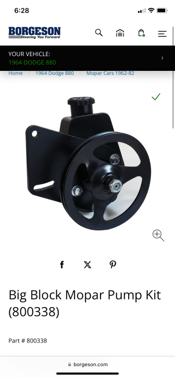

Hello all, wondering if anyone is running one of these Borgeson Big Block Mopar Pump Kits? Part number (800338)
On their site. My pump (on my 64 Dodge 880) has a god awful wobble at the pulley and upon a little further investigation has a good amount of play in the pulley. It squeals the belt at higher RPM. The alignment is all good but when it’s running Ray Charles himself could see the wobble.. finding a rebuilt pump has been a chore to say the least and the ones I do find have a hefty price tag so I’m debating switching to one of these. My question is how well do they work and will i possibly be able to use the same lines already in the car?

You'll definitely need a different pressure line.
That pump may be set up to work with the Borgeson power steering box, so it's possible that the relief pressure could be set different than factory.

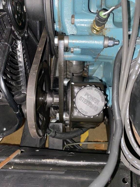

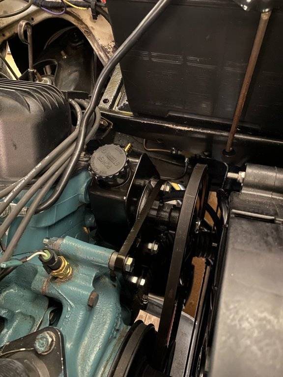

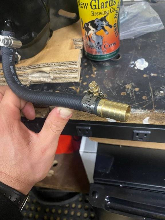

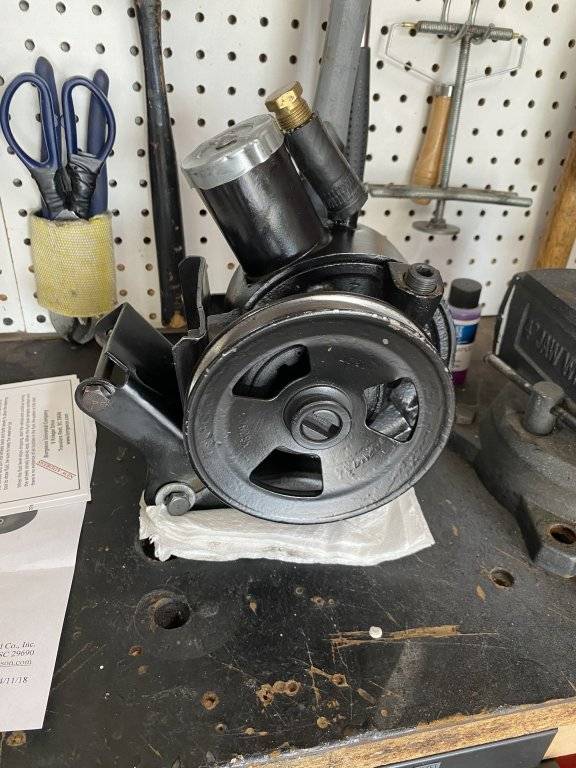

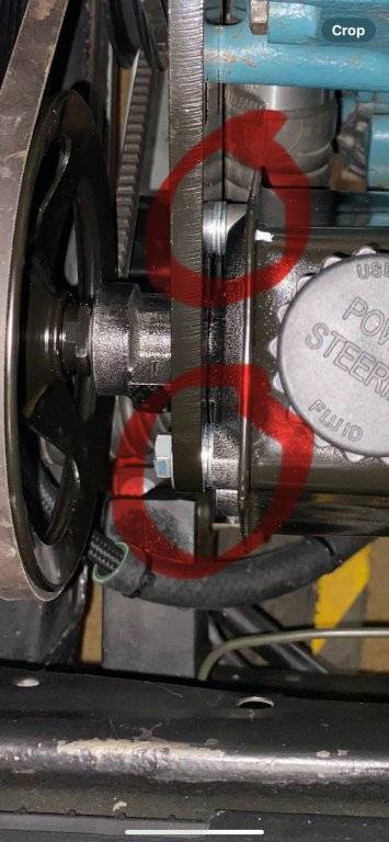

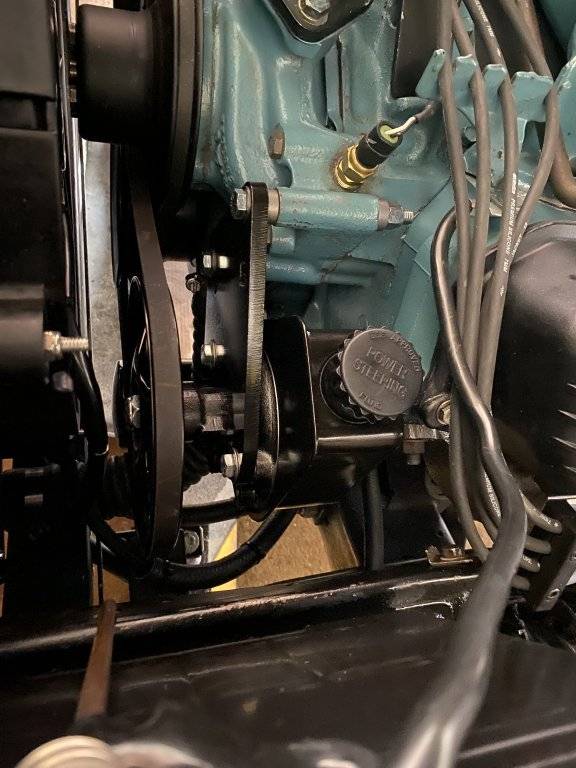

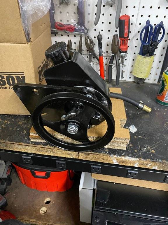

It’s been a little bit, but I took the chance and bought the pump upgrade kit after going back and forth with the Tech department at Borgeson to confirm it indeed would work without running their steering gear box and retaining what I have on the car already. all in all it went in pretty simple. I did have to make a few modifications along the way. I was able to retain my existing pressure line as well as return line. I had to couple the return line with a 5/8” to 3/8” barb and shim the pump itself back slightly from the mount to achieve proper pulley alignment. Runs good, no more wobble, leaks or squeals.
Here are some photos of the install.
