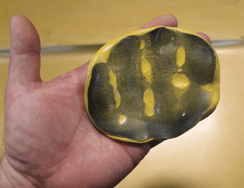

I've never done it but over the winter I clayed the in hellcat because I got into some tar and orange spots. That was tough because it was cold, eventually i figured out to use the hair dryer to help.
The fury was painted in 1999. It was never buffed out enough as the guy lost his shop and actually finished in our shop but didn't do a great job. Even though i waxed it a fair bit over the years it's been really rough feeling for a long time. The clay turned black in a hurry, lots of stuff embedded in the paint.
It's not perfect paint now since it never was, but it's a lot smoother to the touch now. I'm sure a polish and wax would help even more now.

It's not something you see so much as feel. Though I imagine in the right light you could see it. I didn't take any photos yet, I've done the top surfaces which is what contaminates fall in mostly of course. Still need to do the sides

My next purchase is going to be synthetic clay that is supposedly washable and reusable.

I've had a claybar kit for a couple years and keep meaning to do the wagon and the coronet. Do you use one claybar per vehicle or can you do more than one?
I've got a synthetic clay "bar" and I just clean it real good with Dawn when it gets dirty. Done 4 vehicles so far and ready for a 5th. Then I'll probably replace it.
