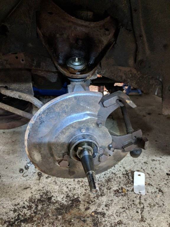

Trial and error I guess. Thinking the rotors are incorrect. Big John is right... If the races go farther into the rotor it will only make it worse.
I can return the rotors still have the receipt. What is a suggested source? Rock didn't have any in stock for Raybestos but they do have centric (45.00)... Napa has some as well (219.00)

Got it. Rotors from Carid were a perfec fit. Shields that I thought wouldn't fit are on as well.

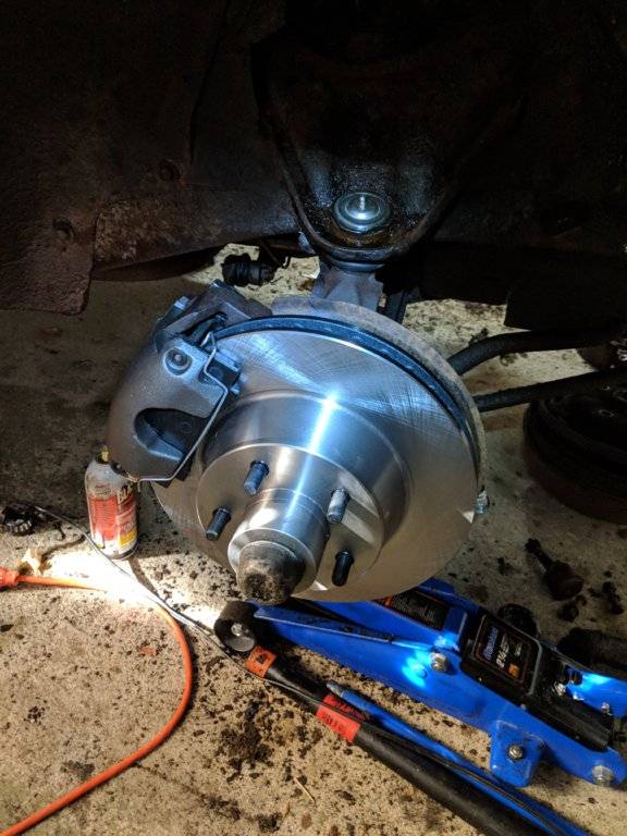

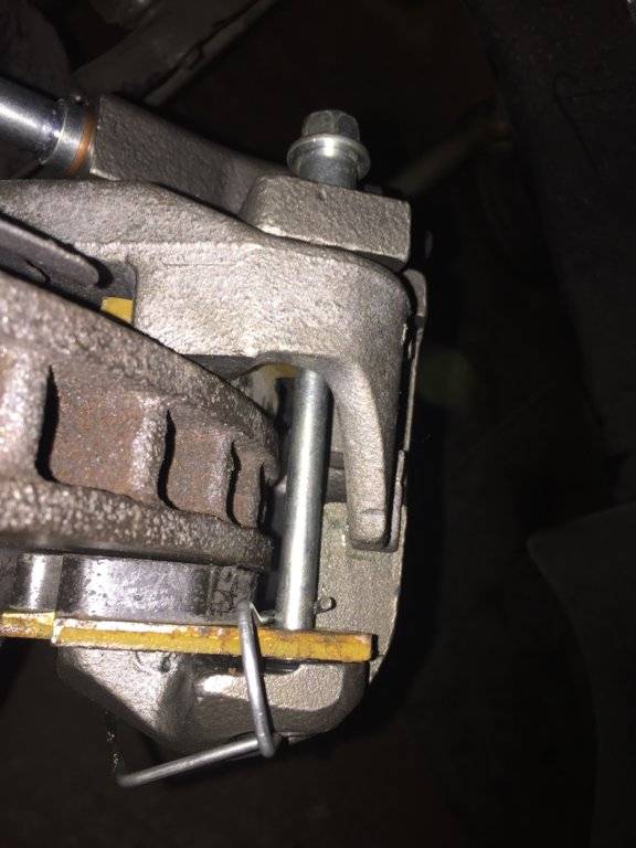

Check the anit-rattle clips, in this position they are likely going to scrub on the rotors...
I think they should be installed like this...

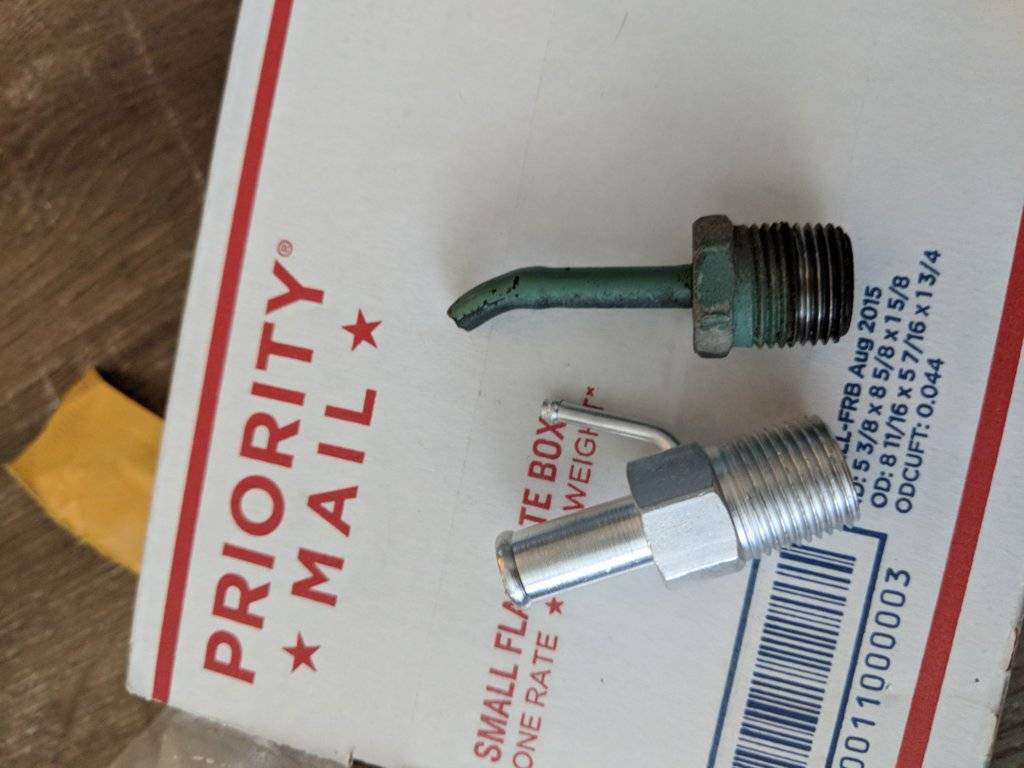

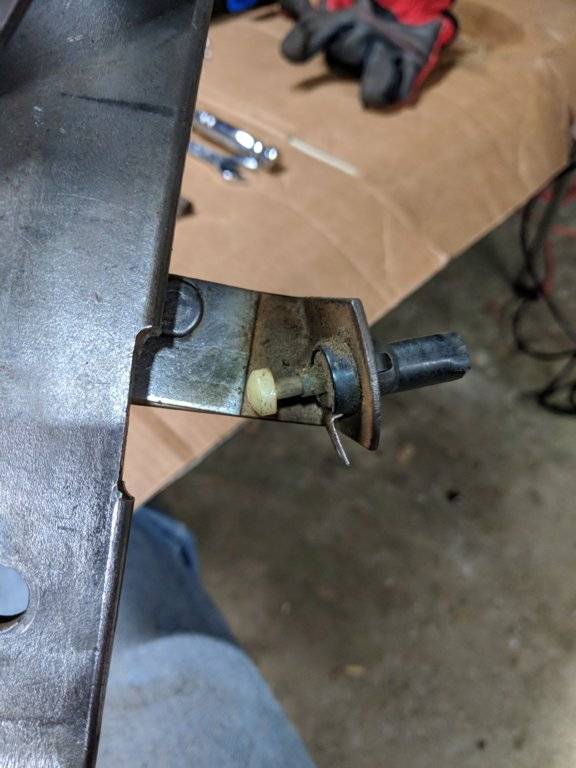

Alright fellas... Conversion is done. And just in time too! One little thing to clean up though. When I was changing over to the disk brake pedal assembly I noticed there was no tip on the tail light sensor (what is this called?) See image. Where can I get one? Can I solder a new tip on? Ended up plugging the line into the one on the base but no luck there.

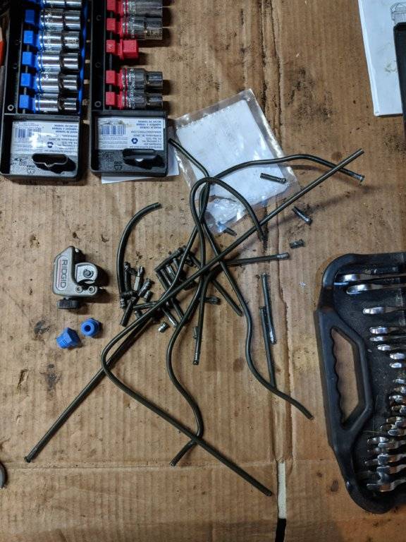

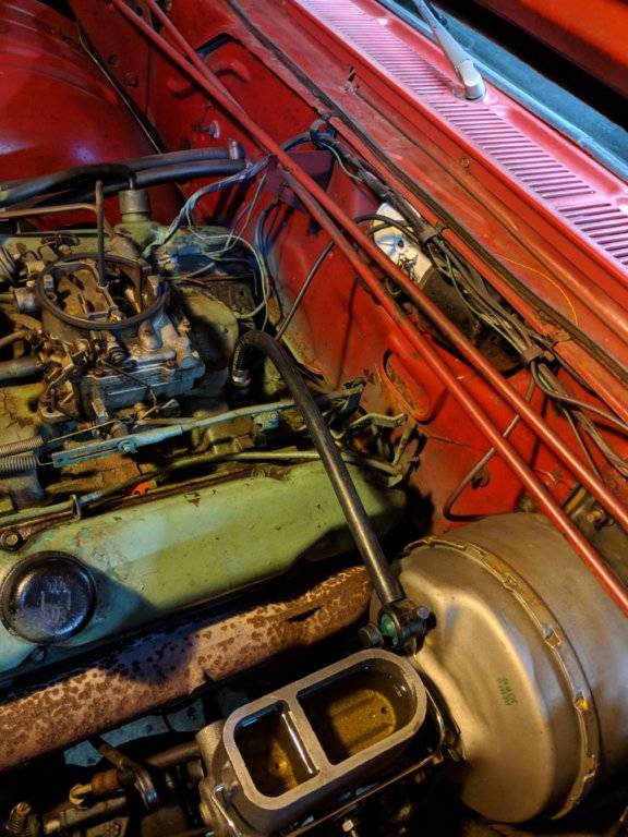

Here are some images of the process. Some good (awaiting a bleed in the street because my garage isn't big enough for me to access all 4 tires at once). Some bad (maybe 50 bad flares before I got consistent).
Brake light switch. NAPA etc should have one... or Rock Auto.
Do not leave the cover off the master cylinder as the brake fluid will pick up moisture from the air. This will cause corrosion issues down the road. As John has noted the part you refer to is the brake light switch and you need a new one.
