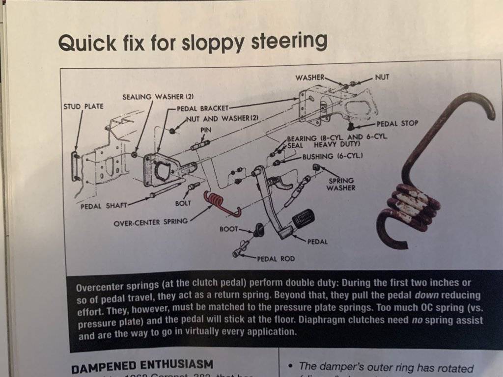

Well mine ain’t gonna help then. What you can do is email Mr Ehrenberg the tech editor at Mopar Action magazine this guy has more factory blueprint type diagrams than anybody. He’s always happy to share. You can expect something like this...
