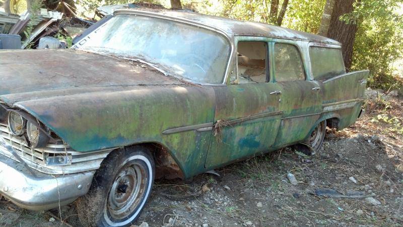

I am upgrading single to double circuit master cylinder, no brainer on that part. Car has the accordion brake booster, and does work properly,but wondering if newer style would interchange since master cylinder studs mounted in firewall, and booster is mounted above.
But, found a post/thing on interweb about upgrading front to disk. I am posting some of what was said, and wondering if any have done, or know of if will interchange. Thanks in advance for any advice.
